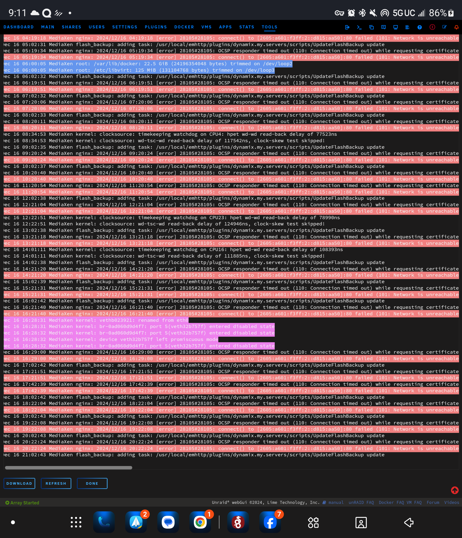

I keep getting this error about every hour. I disabled swag thinking that was it but it's still popping up. I'm not sure what it is or how to fix it?
Thanks,
-Dev
Dec 16 06:19:51 MediaXen nginx: 2024/12/16 06:19:51 [error] 28105#28105: peer: 216.21.170.80:80, certificate: "/boot/config/ssl/certs/certificate_bundle.pem" Dec 16 06:19:51 MediaXen nginx: 2024/12/16 06:19:51 [error] 28105#28105: connect() to [2605:a601:f3ff:2::d815:aa50]:80 failed (101: Network is unreachable) while requesting certificate status, responder: r11.o.lencr.org, peer: [2605:a601:f3ff:2::d815:aa50]:80, certificate: "/boot/config/ssl/certs/certificate_bundle.pem" Dec 16 07:02:32 MediaXen flash_backup: adding task: /usr/local/emhttp/plugins/dynamix.my.servers/scripts/UpdateFlashBackup update Dec 16 07:20:06 MediaXen nginx: 2024/12/16 07:20:06 [error] 28105#28105: OCSP responder timed out (110: Connection timed out) while requesting certificate status, responder: r11.o.lencr.org, peer: 216.21.170.80:80, certificate: "/boot/config/ssl/certs/certificate_bundle.pem" Dec 16 07:20:06 MediaXen nginx: 2024/12/16 07:20:06 [error] 28105#28105: connect() to [2605:a601:f3ff:2::d815:aa50]:80 failed (101: Network is unreachable) while requesting certificate status, responder: r11.o.lencr.org, peer: [2605:a601:f3ff:2::d815:aa50]:80, certificate: "/boot/config/ssl/certs/certificate_bundle.pem" Dec 16 08:02:33 MediaXen flash_backup: adding task: /usr/local/emhttp/plugins/dynamix.my.servers/scripts/UpdateFlashBackup update Dec 16 08:20:11 MediaXen nginx: 2024/12/16 08:20:11 [error] 28105#28105: OCSP responder timed out (110: Connection timed out) while requesting certificate status, responder: r11.o.lencr.org, peer: 216.21.170.80:80, certificate: "/boot/config/ssl/certs/certificate_bundle.pem" Dec 16 08:20:11 MediaXen nginx: 2024/12/16 08:20:11 [error] 28105#28105: connect() to [2605:a601:f3ff:2::d815:aa50]:80 failed (101: Network is unreachable) while requesting certificate status, responder: r11.o.lencr.org, peer: [2605:a601:f3ff:2::d815:aa50]:80, certificate: "/boot/config/ssl/certs/certificate_bundle.pem" Dec 16 08:34:53 MediaXen kernel: clocksource: timekeeping watchdog on CPU4: hpet wd-wd read-back delay of 77523ns Dec 16 08:34:53 MediaXen kernel: clocksource: wd-tsc-wd read-back delay of 117542ns, clock-skew test skipped! Dec 16 09:02:35 MediaXen flash_backup: adding task: /usr/local/emhttp/plugins/dynamix.my.servers/scripts/UpdateFlashBackup update Dec 16 09:20:24 MediaXen nginx: 2024/12/16 09:20:24 [error] 28105#28105: OCSP responder timed out (110: Connection timed out) while requesting certificate status, responder: r11.o.lencr.org, peer: 216.21.170.80:80, certificate: "/boot/config/ssl/certs/certificate_bundle.pem" Dec 16 09:20:24 MediaXen nginx: 2024/12/16 09:20:24 [error] 28105#28105: connect() to [2605:a601:f3ff:2::d815:aa50]:80 failed (101: Network is unreachable) while requesting certificate status, responder: r11.o.lencr.org, peer: [2605:a601:f3ff:2::d815:aa50]:80, certificate: "/boot/config/ssl/certs/certificate_bundle.pem" Dec 16 10:02:37 MediaXen flash_backup: adding task: /usr/local/emhttp/plugins/dynamix.my.servers/scripts/UpdateFlashBackup update Dec 16 10:20:40 MediaXen nginx: 2024/12/16 10:20:40 [error] 28105#28105: OCSP responder timed out (110: Connection timed out) while requesting certificate status, responder: r11.o.lencr.org, peer: 216.21.170.80:80, certificate: "/boot/config/ssl/certs/certificate_bundle.pem" Dec 16 10:20:40 MediaXen nginx: 2024/12/16 10:20:40 [error] 28105#28105: connect() to [2605:a601:f3ff:2::d815:aa50]:80 failed (101: Network is unreachable) while requesting certificate status, responder: r11.o.lencr.org, peer: [2605:a601:f3ff:2::d815:aa50]:80, certificate: "/boot/config/ssl/certs/certificate_bundle.pem" Dec 16 11:20:54 MediaXen nginx: 2024/12/16 11:20:54 [error] 28105#28105: OCSP responder timed out (110: Connection timed out) while requesting certificate status, responder: r11.o.lencr.org, peer: 216.21.170.80:80, certificate: "/boot/config/ssl/certs/certificate_bundle.pem" Dec 16 11:20:54 MediaXen nginx: 2024/12/16 11:20:54 [error] 28105#28105: connect() to [2605:a601:f3ff:2::d815:aa50]:80 failed (101: Network is unreachable) while requesting certificate status, responder: r11.o.lencr.org, peer: [2605:a601:f3ff:2::d815:aa50]:80, certificate: "/boot/config/ssl/certs/certificate_bundle.pem" Dec 16 12:02:38 MediaXen flash_backup: adding task: /usr/local/emhttp/plugins/dynamix.my.servers/scripts/UpdateFlashBackup update Dec 16 12:21:04 MediaXen nginx: 2024/12/16 12:21:04 [error] 28105#28105: OCSP responder timed out (110: Connection timed out) while requesting certificate status, responder: r11.o.lencr.org, peer: 216.21.170.80:80, certificate: "/boot/config/ssl/certs/certificate_bundle.pem" Dec 16 12:21:04 MediaXen nginx: 2024/12/16 12:21:04 [error] 28105#28105: connect() to [2605:a601:f3ff:2::d815:aa50]:80 failed (101: Network is unreachable) while requesting certificate status, responder: r11.o.lencr.org, peer: [2605:a601:f3ff:2::d815:aa50]:80, certificate: "/boot/config/ssl/certs/certificate_bundle.pem" Dec 16 12:22:51 MediaXen kernel: clocksource: timekeeping watchdog on CPU23: hpet wd-wd read-back delay of 78990ns Dec 16 12:22:51 MediaXen kernel: clocksource: wd-tsc-wd read-back delay of 124946ns, clock-skew test skipped! Dec 16 13:02:38 MediaXen flash_backup: adding task: /usr/local/emhttp/plugins/dynamix.my.servers/scripts/UpdateFlashBackup update Dec 16 13:21:18 MediaXen nginx: 2024/12/16 13:21:18 [error] 28105#28105: OCSP responder timed out (110: Connection timed out) while requesting certificate status, responder: r11.o.lencr.org, peer: 216.21.170.80:80, certificate: "/boot/config/ssl/certs/certificate_bundle.pem" Dec 16 13:21:18 MediaXen nginx: 2024/12/16 13:21:18 [error] 28105#28105: connect() to [2605:a601:f3ff:2::d815:aa50]:80 failed (101: Network is unreachable) while requesting certificate status, responder: r11.o.lencr.org, peer: [2605:a601:f3ff:2::d815:aa50]:80, certificate: "/boot/config/ssl/certs/certificate_bundle.pem" Dec 16 14:01:11 MediaXen kernel: clocksource: timekeeping watchdog on CPU16: hpet wd-wd read-back delay of 108393ns Dec 16 14:01:11 MediaXen kernel: clocksource: wd-tsc-wd read-back delay of 111885ns, clock-skew test skipped! Dec 16 14:02:38 MediaXen flash_backup: adding task: /usr/local/emhttp/plugins/dynamix.my.servers/scripts/UpdateFlashBackup update Dec 16 14:21:20 MediaXen nginx: 2024/12/16 14:21:20 [error] 28105#28105: OCSP responder timed out (110: Connection timed out) while requesting certificate status, responder: r11.o.lencr.org, peer: 216.21.170.80:80, certificate: "/boot/config/ssl/certs/certificate_bundle.pem" Dec 16 14:21:20 MediaXen nginx: 2024/12/16 14:21:20 [error] 28105#28105: connect() to [2605:a601:f3ff:2::d815:aa50]:80 failed (101: Network is unreachable) while requesting certificate status, responder: r11.o.lencr.org, peer: [2605:a601:f3ff:2::d815:aa50]:80, certificate: "/boot/config/ssl/certs/certificate_bundle.pem" Dec 16 15:02:39 MediaXen flash_backup: adding task: /usr/local/emhttp/plugins/dynamix.my.servers/scripts/UpdateFlashBackup update Dec 16 15:21:31 MediaXen nginx: 2024/12/16 15:21:31 [error] 28105#28105: OCSP responder timed out (110: Connection timed out) while requesting certificate status, responder: r11.o.lencr.org, peer: 216.21.170.80:80, certificate: "/boot/config/ssl/certs/certificate_bundle.pem" Dec 16 15:21:31 MediaXen nginx: 2024/12/16 15:21:31 [error] 28105#28105: connect() to [2605:a601:f3ff:2::d815:aa50]:80 failed (101: Network is unreachable) while requesting certificate status, responder: r11.o.lencr.org, peer: [2605:a601:f3ff:2::d815:aa50]:80, certificate: "/boot/config/ssl/certs/certificate_bundle.pem" Dec 16 16:02:42 MediaXen flash_backup: adding task: /usr/local/emhttp/plugins/dynamix.my.servers/scripts/UpdateFlashBackup update

The problem started after a flash backup, please try rebooting and post new diags if it starts again.
