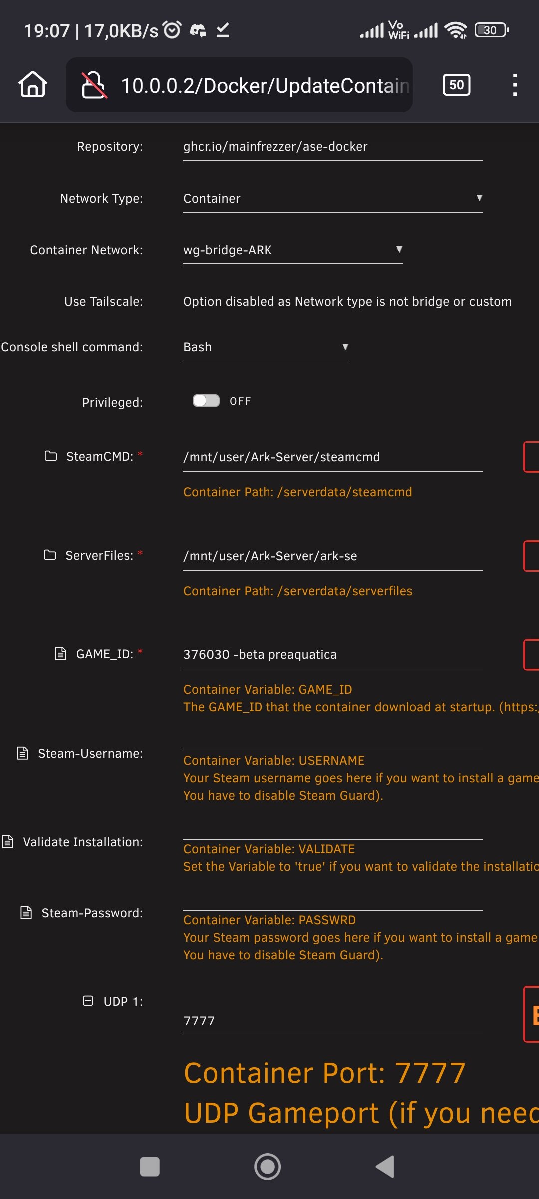

Hi, i bothered you with my Ark Server from your template some time ago, thanks again for your help back then, worked out fine.
My friends asked me to try to revert our server back to an older version, pre aquatica, as we still have problems and cant upload any dinos.
We found those steam posts about reverting servers back to a fixed version:
https://steamcommunity.com/app/346110/discussions/0/596280581879358180/
https://steamcommunity.com/app/346110/discussions/0/596280581879318721/#c596280581879322656
Basically this line
app_update 376030 -beta preaquatica validate
should be added to some server start file, but I'm not sure how this works for your container as much of this is generated from the unraid interface as far as i understand?
u think this is doable without much hassle?
thanks for any advice
Basically this line
It's all doable in the template
Oh thanks m8, will try.
Thought that number was a internal version number or something, didnt realise it's just the game id^^

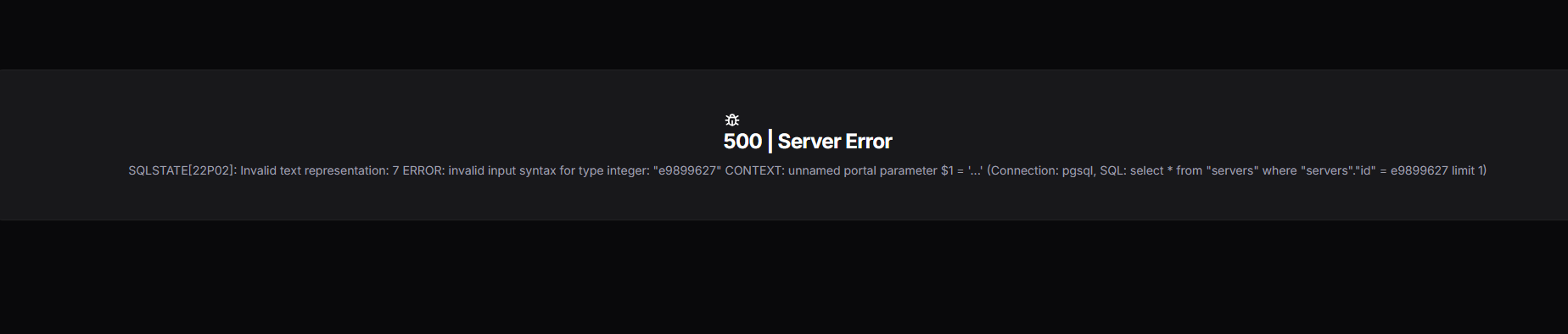

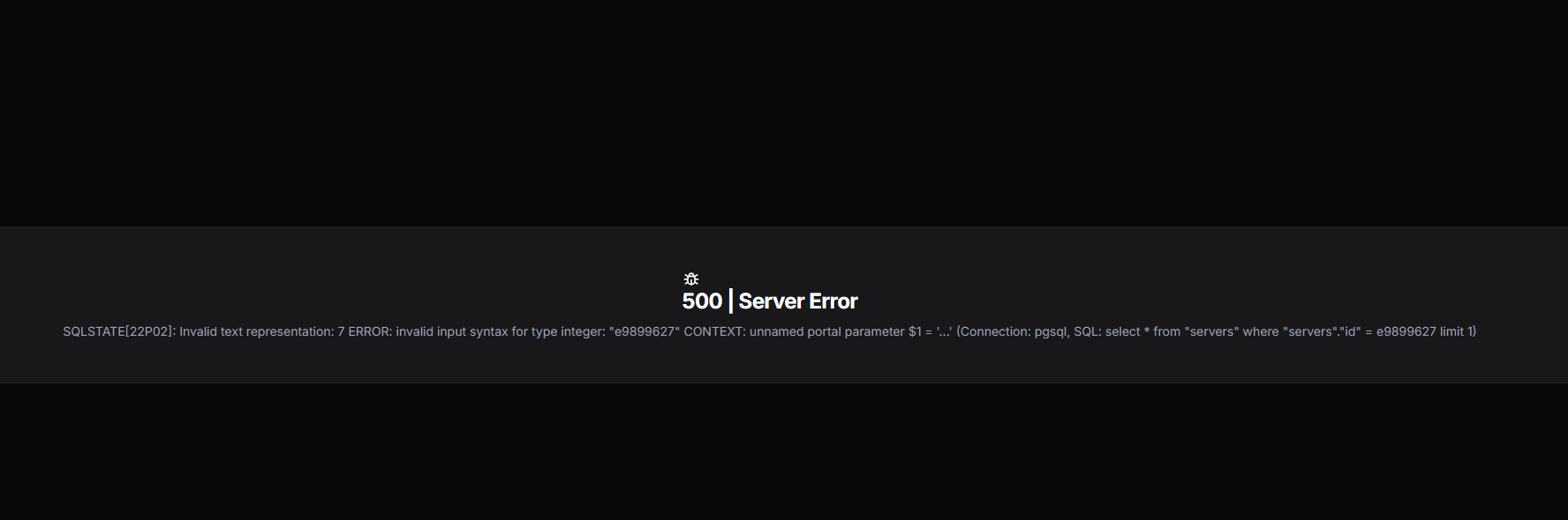

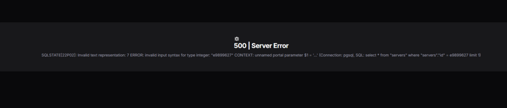

updated to the latest pelican update an now when i press on any server this error comes
did you update wings to the latest version (beta18) as well? also which pelican container are you using? mine or the official one?
Edit: (if its the official one. You have to wait till they release an update to it, there is a fix for it https://github.com/pelican-dev/panel/pull/1787
mine has that already included, so if its still broken, would be worth knowing)
Edited by Mainfrezzer
yep updated both
i use yours
21 minutes ago, Onyxdigital said:
yep updated both
i use yours
If youre willing to test something, could you change the repository from the panel from "ghcr.io/mainfrezzer/pelican-panel:latest" to "magnon.ovh/mainfrezzer/pelican-panel:latest" and see if its still borked?
still error
Did apply the rollback and it should work again now. Seemed to be very specific to postgres for some reason, although i didnt check mysql.
