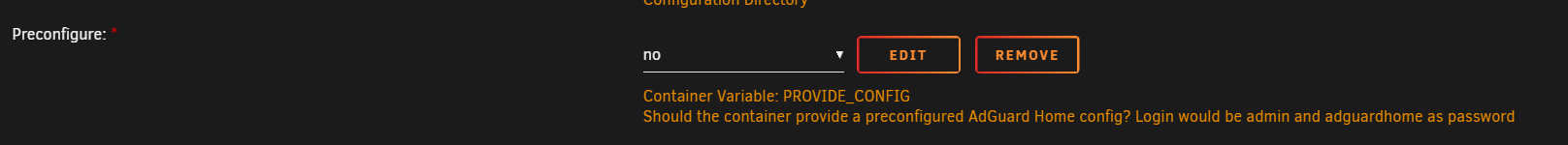

Ive updated the adguard-unbound container and template to include the following option
By default, its set to no, and you have to go through the usual setup-steps of adguard. If you pick yes and theres no AdGuardHome.yaml present at the config directory, it will copy the following file to that location and use it
https://raw.githubusercontent.com/Mainfrezzer/adguardhome-unbound/refs/heads/main/additions/etc/AdGuard/AdGuardHome.yaml

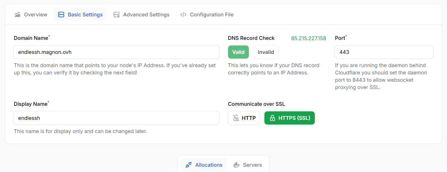

based on your screenshot, i assume youre using ssl, but for some reason you picked http communication instead of https?
Edited by Mainfrezzer

3 minutes ago, Jamfin said:
Yeah - I read your response to the turning off SSL if the wing is behind the proxy above due to the erroring of the certificates. Should I just point that to where the certificate is signed in my Caddy?
You need to keep the Https(SSL) in the Panel itself active, if you want the Panel to access a https website.
The comment for disabling the ssl is just needed within the config.yml inside the wing container itself cause, well you outsource the encryption part^^
Thanks for that confirmation! I've now switched it to HTTPS and still no progress, no message within the console debug either, still blank.
yeah, the 502 is odd. I would suspect theres an issue with either the port mappings from the container or the forwarding over tailscale

Brilliant - thank you for confirming. It was due to the port in the configuration file being 443 and not the default container one of 8080. Not sure how it managed to get like that. Thanks for the swift responses, you've saved my bacon.
Good day,
Can you please assist, not getting the node and panel to communicate.
I'm not sure what I am doing wrong here but I think all ports are setup correctly:
Panel:
config.yml
Tried to change the port to 8080 for the node.
cloudflare
console curl
I can access both the panel and the wings via the cloudflare addresses given, bit for some reason they do not want to connect:
I am using network custom : br0 -- management for the containers with static IP's on my home network.
I've turned off ADGUARD protection to see if it helps.
Not sure how to see what DNS servers these dockers are using, as I set my DHCP on router to use ADGUARD DNS.
This is the unraid routing table if this can help:
Edit: I stopped the docker and vm's on my unraid, changed the host DNS to use 1.1.1.1 (Cloudflare) started up everything and now they are connecting.
Is this normal that I cannot select my host IP for Allocations, only cloudflares public DNS IP's:
Edited by Dr0on
For the
9 hours ago, Dr0on said:
Good day,
Panel:
config.yml
cloudflare
console curl
Glad the first thing was solved.
The allocation part is a bit unintuitive, i would say.
Just pick any ip and after you added them, you can do the following
0.0.0.0 ensures the gameserver is listening to all interfaces and can actually start and not complain about not being able to bind to that ip address and the alias, is what is shown everywhere in the ui. So you can pick what address is to be shown.
Sorry if this has been answered - but what is the ideal solution for Adguard and Tailscale? I am running unraid 7 rc2 and using the tailscale function. I would like to run adguard when I am connected to my tailnet.
Hello I have restarted my Palworld server and somehow my docker network got changed to IP-192-168-0-20 instead of pelican_net and my game progress went back to 0. Is there any way to get it back to pelican_net?
It depends how youre running the container and how the vpn connection is made. I havent messed around with Tailscale at all so i cant say anything about the integration part of it.
Generally i would assume, once you added the Adguard container to the tailscale network, its as simple as to declare that tailscale ip as DNS Server(if you didnt limit the listening interfaces to a single one)
