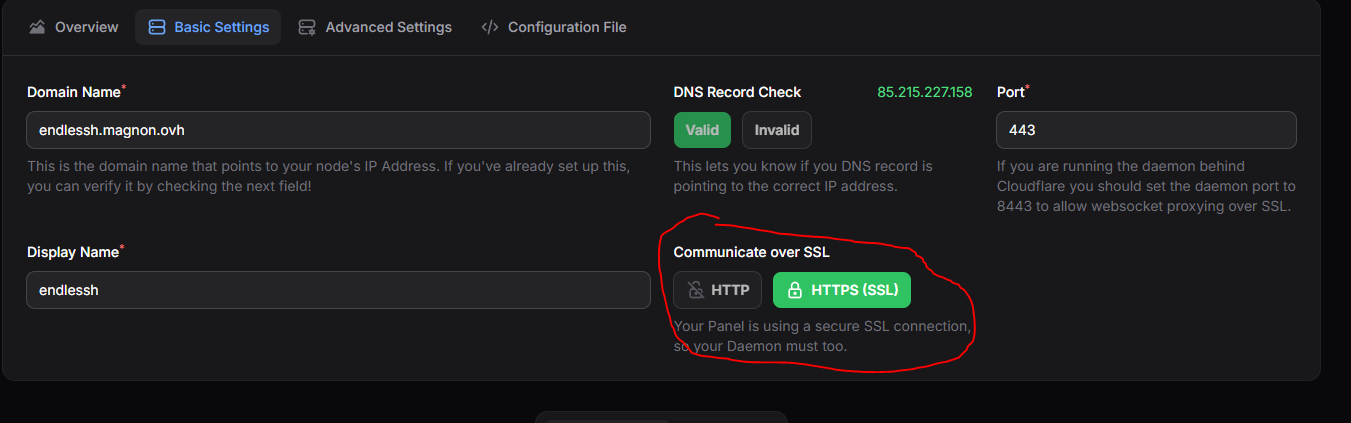

you need to turn ssl in the panel on. the panel is trying to reach your node over http
Tried that still same issue:
what port did you enter in the panel for the node address? i hope its 443 and not 8443^^
Facepalming myself it was 8080 still popped in 443 and we are green. I think thie text under the panel confused me "If you are running the daemon behind Cloudflare you should set the daemon port to 8443 to allow websocket proxying over SSL."
yeah what the cloudflare notice is about, i personally have no clue either. Never seen it not work over the default 443. Even cloudflare states

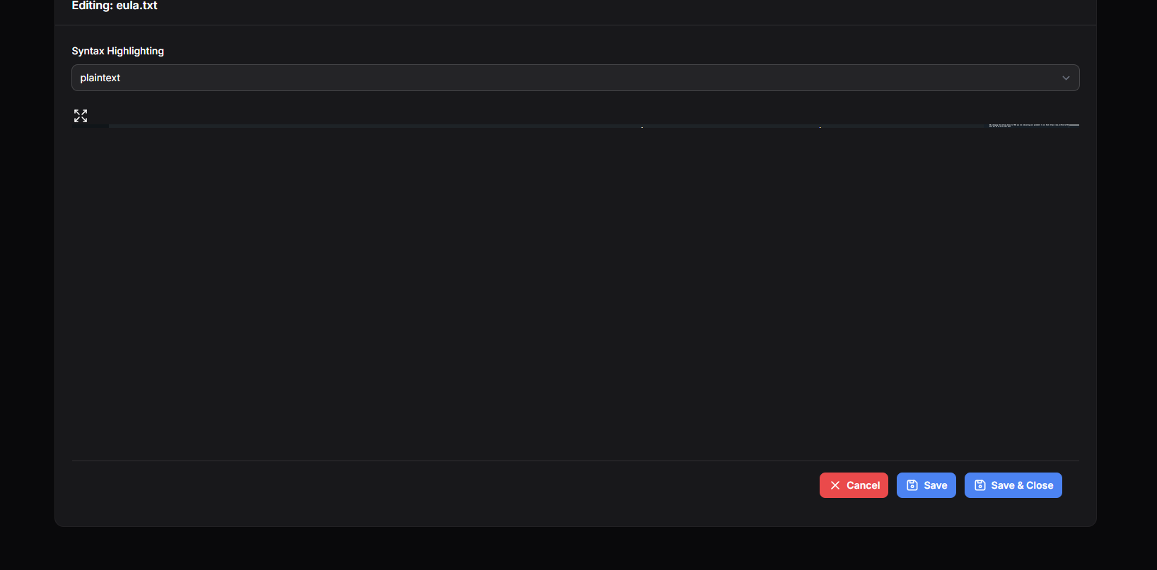

Hi sorry to bother you guys but does anyone know why my text editor is just scrunched up like this?
I've already searched here and found a fix with uploading files, which I really appreciate so much to the person that posted that about adding the IP address to the list! :D But now i'm just stuck with the editor looking like this, I've tried using different browsers, Edge, Vivalidi, A few chromium based browsers and firefox based ones as well and they all show up like that. I even tried my phone and it looks like that .-.
For some reason its not loading/failing to load a css file. ive had that happen to me once too.
and it just happened again to me too
ill look into it too see whats causing it.
Sounds good thanks!

1 hour ago, tier1kill said:
Sounds good thanks!
its an odd bug, it a 50:50 if it appears or not while building the image, ill pushed an update
Edited by Mainfrezzer
Fantastic! thanks!
IT WORKS! Thank you so much! I can finally edit everything in the panel without having studio code open on a different monitor 😅
