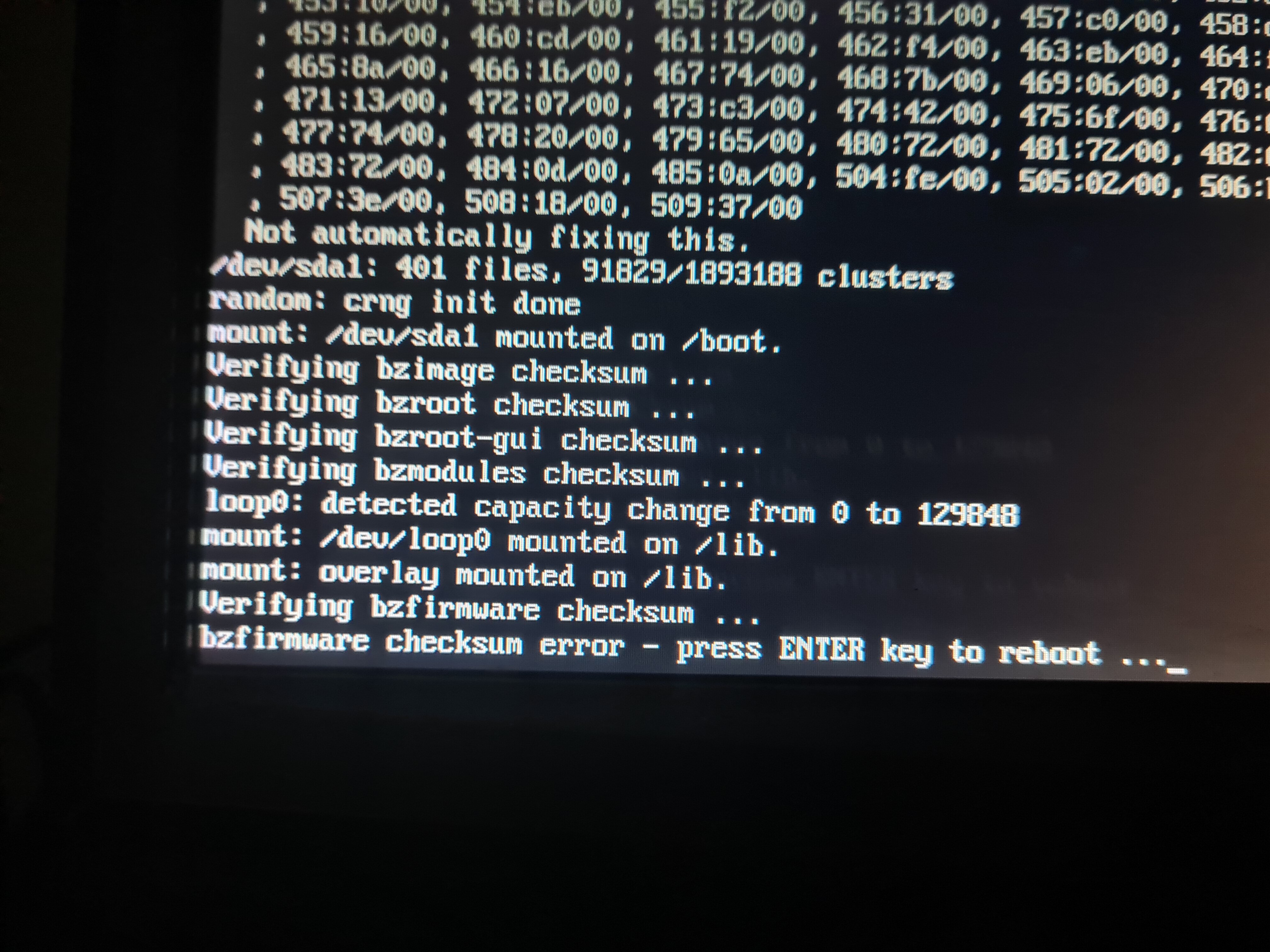

upon reboot was met again with bzfirmware checksum error - see attached photo
recreated the flash drive again and copied over contents of the config folder.
Booted back up fine then.
This error had to either be RAM or problems with that file on the flash drive.    I would suggests downloading the zip file for the Unraid version you are using and then extracting all the bz* type files overwriting the ones on the flash drive.
