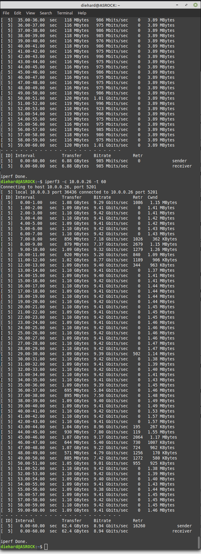

I bonded 2 10gig on the unraid server, so thats 20gigs right, but the other 2 linux boxed are not bonded.
the 2nd linux has worst performance.  I also did the test in reverse and it maxes out.

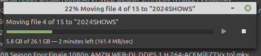

tested the speed to NVME on the unraid network and still think this is slow and should be much faster, what do you guys think about this speed sending to unraid , with bonded 10 gigs, NVME 2tb?

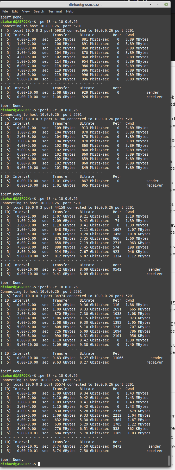

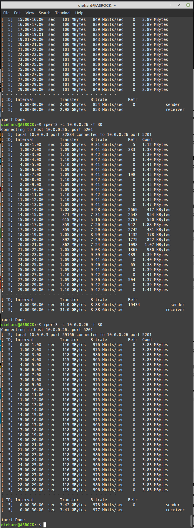

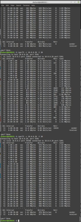

I reset the bond but that didnt help I thing the speed got worse.
Do you have any ideas whatelse i can look at until i get the windows machine up and running?
