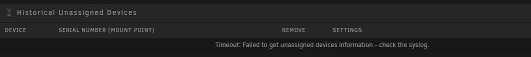

So i decided to upgrade to Beta 4 and looks like it partial worked with getting the array to start but one of the deivces will not mount. If i try to mount it crashed the Unassigned disks.

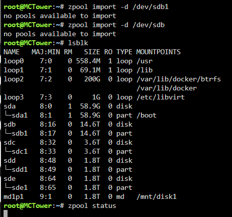

@JorgeB So when i try to perform any zpool/zfs list command it does not list the pool or share. Not able to mount or import it. I did try to mount read only still not able to. zpool import -o readonly=on Plex

Was it encrypted?
If not, post the output from
zpool import -d /dev/sdX1
and
zpool status

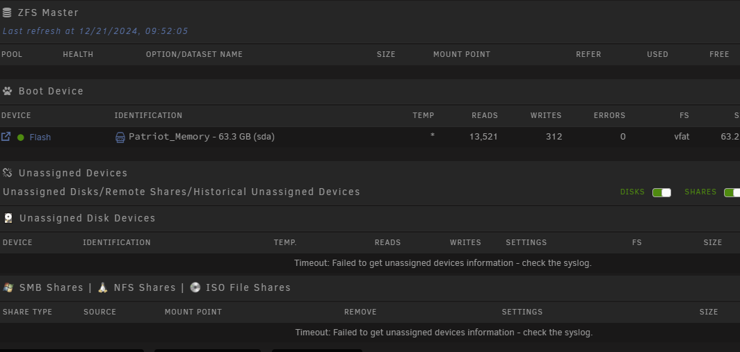

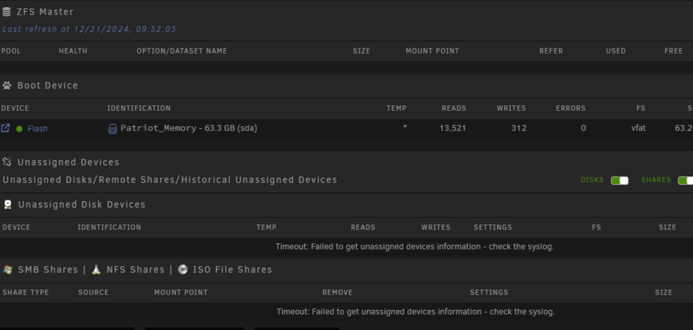

When trying to mount the drive will not find it. I have tried commands below.
When i use the zpool command it freezes and kills the ui plugins for assigned and zfs. I have to reboot to get it to come back
Sound like a corrupt filesystem, but without any output from zpool import, it-s the most I can say.
