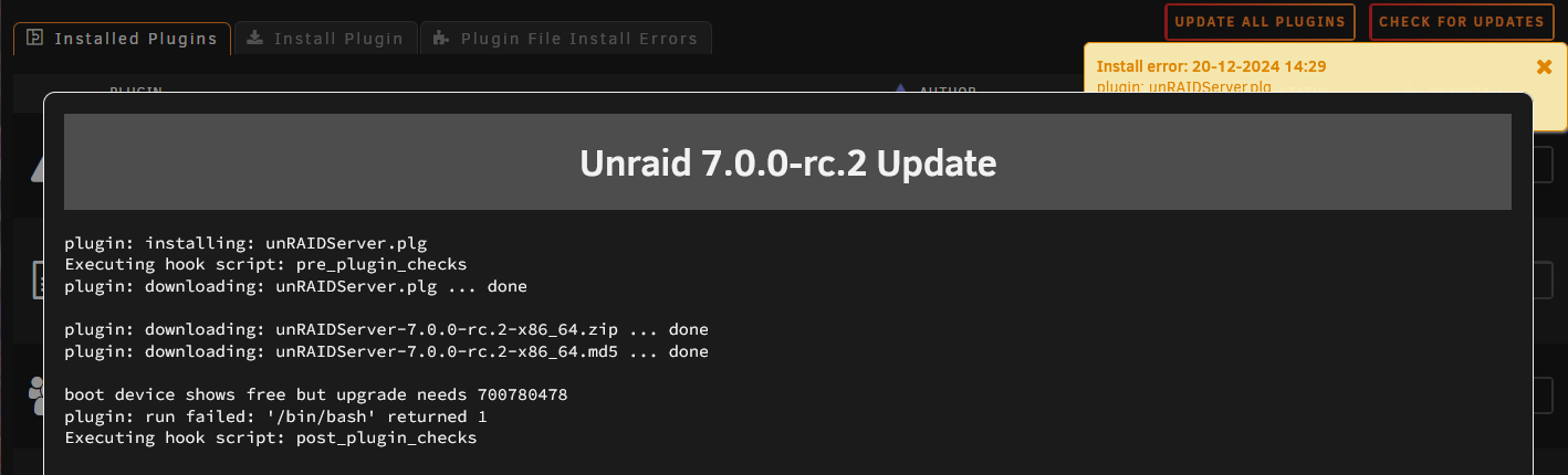

Update to 7.0.0-rc.2 fail unRAIDServer.plg plugin fail to install
plugin: installing: unRAIDServer.plg
Executing hook script: pre_plugin_checks
plugin: downloading: unRAIDServer.plg ... done
plugin: downloading: unRAIDServer-7.0.0-rc.2-x86_64.zip ... done
plugin: downloading: unRAIDServer-7.0.0-rc.2-x86_64.md5 ... done
boot device shows free but upgrade needs 700780478
plugin: run failed: '/bin/bash' returned 1
Executing hook script: post_plugin_checks
Im running 7.0.0-beta 4 and trying to update to 7.0.0-rc.2 It seems the plugin unRAIDServer.plg is failing to install.
Any ideas how to rectify the situation?

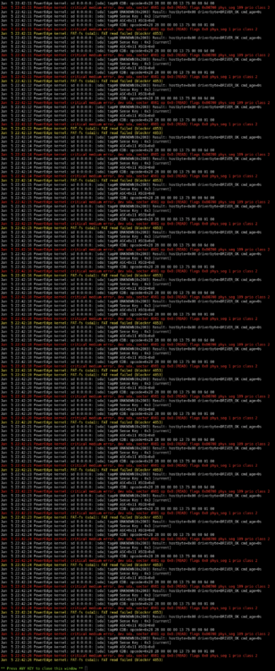

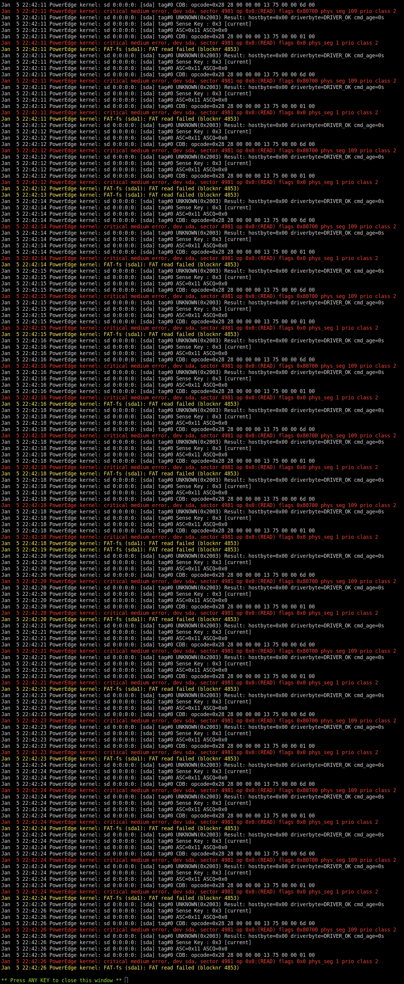

Not sure what going on with the flash drive it shows zero bytes used and zero bytes free.
Its a 30GB drive, the last time I paid attention to its size it had more than 75% free space from what I can remember.
Click the little blue thumbdrive icon next to the drive name post the log
Edited by MowMdown
I wasnt sure how to copy the log here is a screenshot.
Since it shows no free space used or free, and the many errors in the log, your USB device has failed and needs to be replaced.

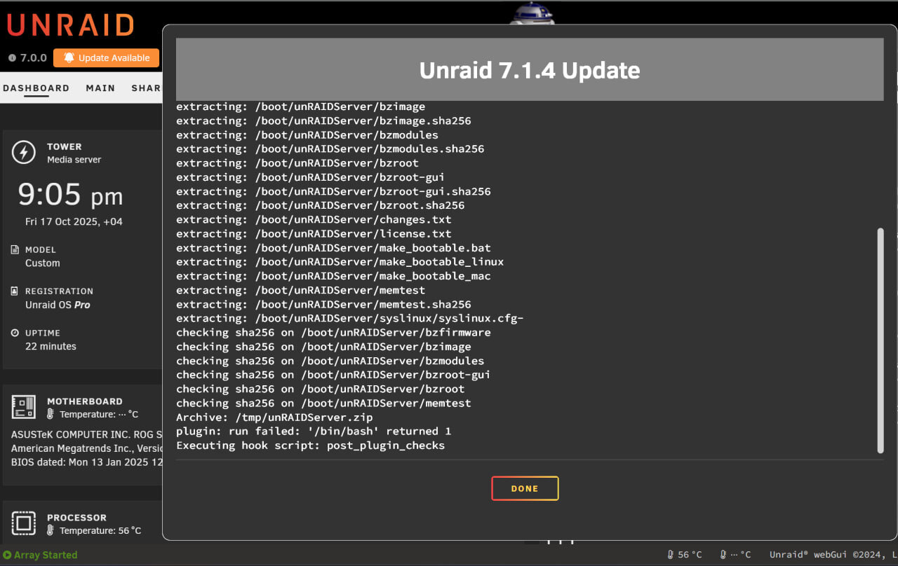

I know this is an old thread, but I'm getting the same Install error
plugin: unRAIDServer.plg
Plugin failed to install
I'm on v7.2.2 and tried to upgrading to 7.2.3 and even the new 7.3.0 with the same error. I've proactively attached my diagnostics zip file for your reading pleasure.
Thanks in advance for any help you can give.
newtower-diagnostics-20260522-1229.zip
Up
Connect is out of date; it should say that you need to update Connect first: Plugins - Update All.
dynamix.unraid.net.plg - 2025.11.21.0223 (Update available: 2026.05.11.1745)
Wow, that was frustrating. :) I updated all the apps, but didn’t check plug-ins. Thank you!
