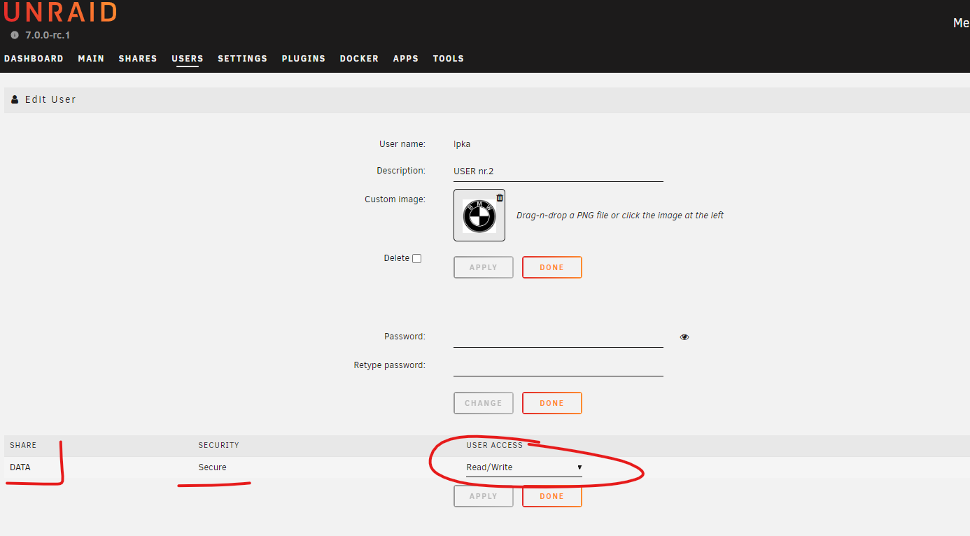

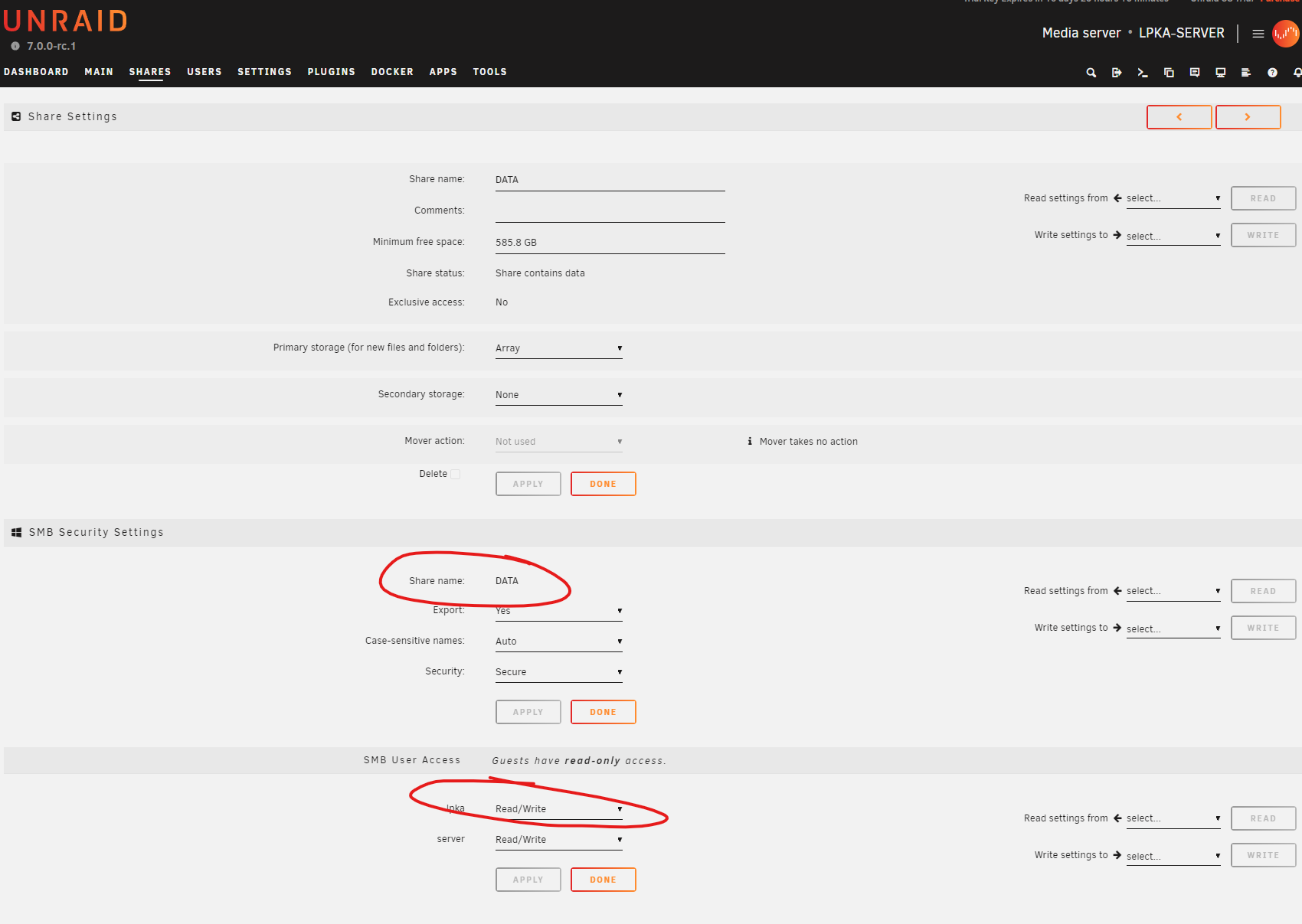

Hello everybody. First time here. Been testing Unraid for two weeks, all was OK. Than I installed couple  of plugins and tried a few VPN, but at the end deleted all addons, but now all of the sudden Can not connect to unRaid share.

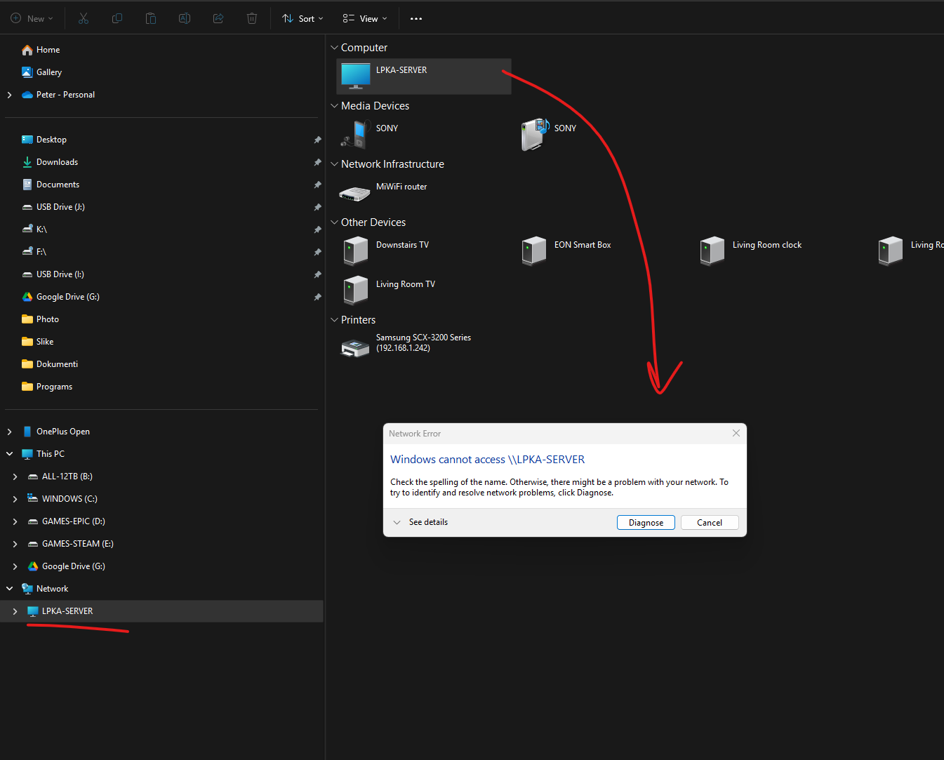

I tried making new user, updating the old one, Tried 4 different PC all windows 11. And nobody lets me in. I just copied every PHOTO and movie into the new  NAS and now I'm afraid I have to do it all over again, but thinking not using unraid. THis is the only setback that I have but ca not SOLVE IT. Need help.
I was copying files left and right 3 days ago. Now I'm stuck. On my PC it says I can't access the server. On others it gives me that my password is not correct.

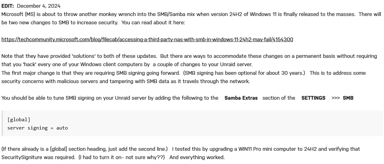

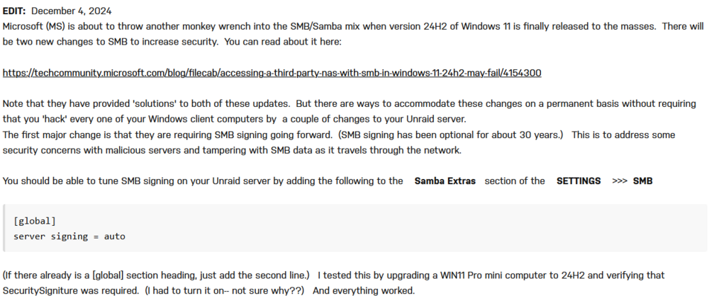

Solved by Frank1940
Also this one if you are using ver 24H2...
