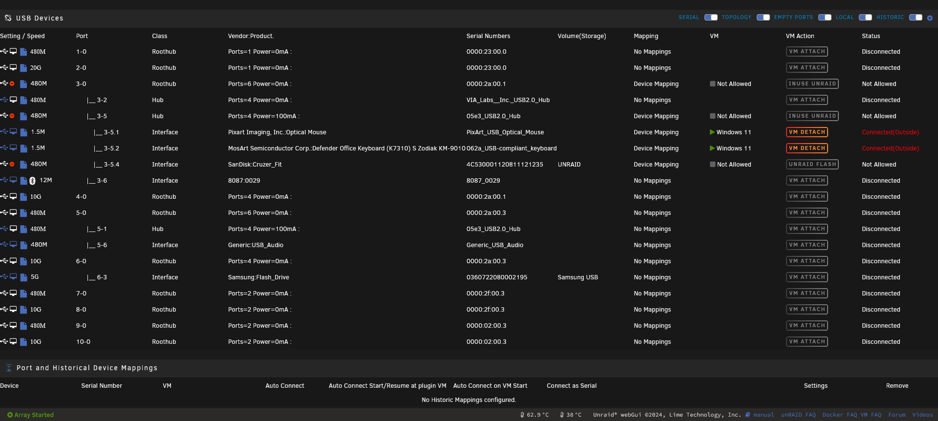

had the issue again, using the mouse as normal, as the mouse just dropped out the device disconnected sound. it's plugged directly into the motherboard at the back. Shows as connected, but the keyboard is shows as disconnected outside by works fine. Unsure if upgrading to latest stable would make any difference, but need a whole day in case something goes southimage.thumb.png.ef8ae5a83807885b41b6143fa1f8e7f4.png

Does seem to look like the mouse is resetting itself.
