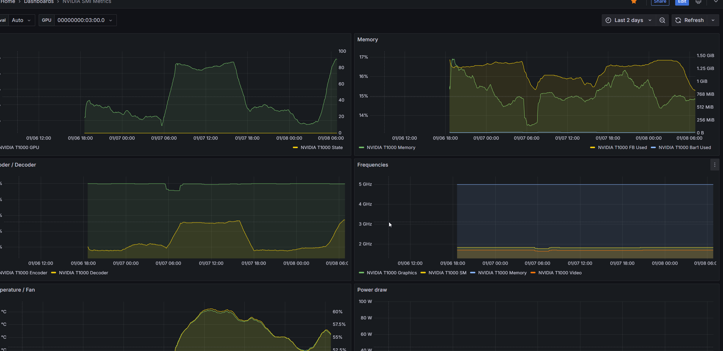

as its a Xeon server and wanted to see stats,the GPU remained. i set up tdarr and set off to convert my library and currently 6 days (touch wood) constant running.
The GPU is being used a lot with the encode/decode action.
I don't know  it is classed as solved as i await my testing period and its happy away, its good enough to close.
