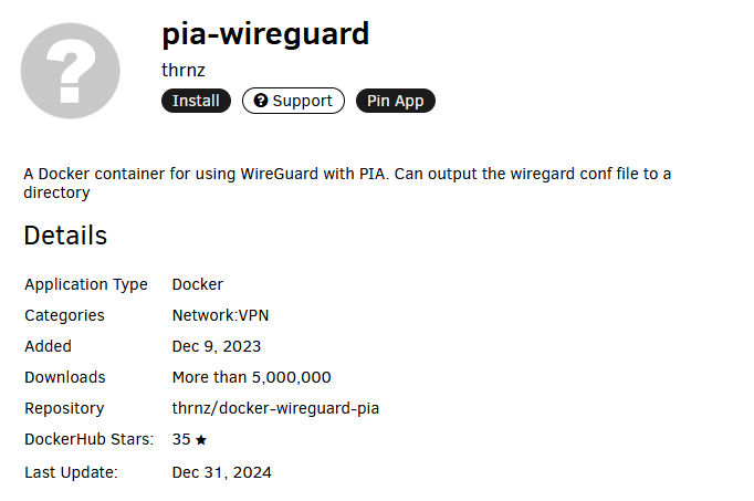

I assume your using this docker:
for PIA VPN setup and access.

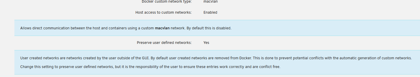

Other Docker setting...

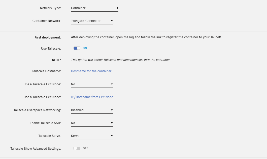

with unraid 7 rc2 its a mater of telling other dockers to use them for the network
example v7 rc2 docker template setup for
twingate or talescale:
filling in tailscale settings if wanted/necessary...
