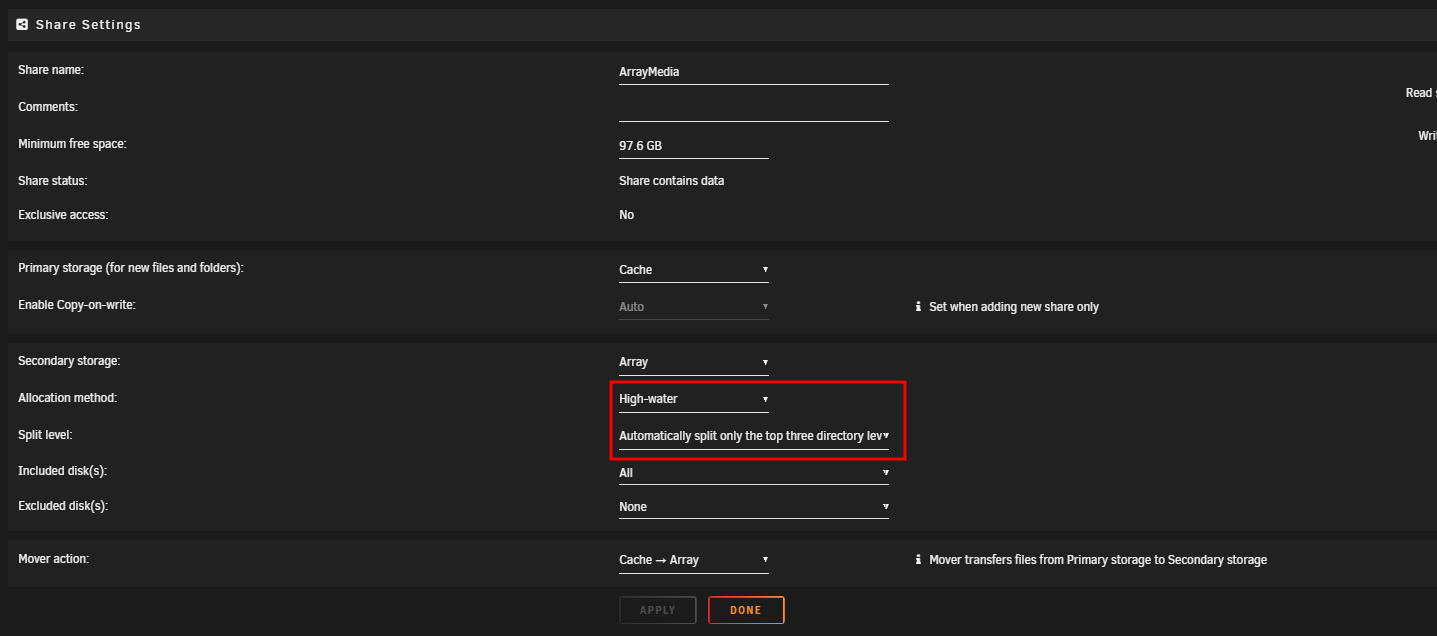

I can't seam to get mover to use my new 20TB drive in my array.
I have set my split level like thisย

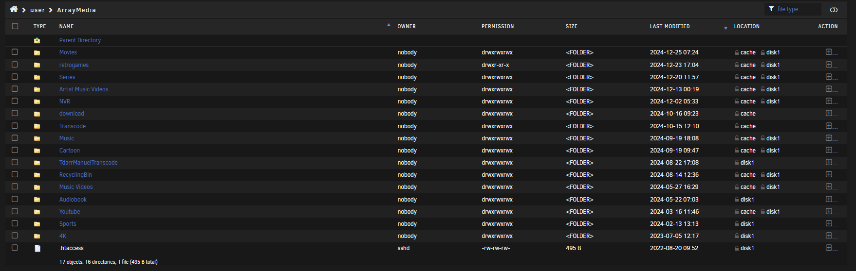

And library layout is like this

It might be your Split Level (depending on the path of the new files) as Split Level takes precedence over Allocation Method if there is contention between them over which drive to use.

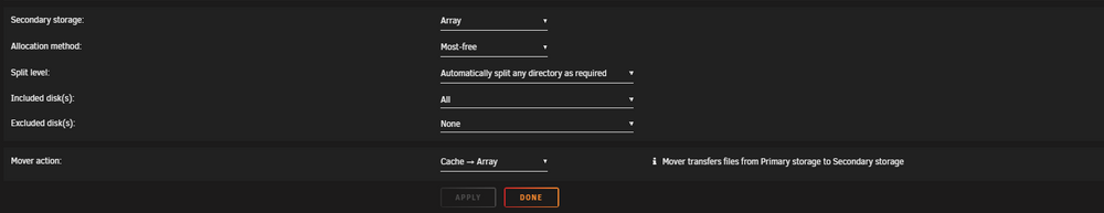

Will try this.
This should work, and start filling the empty 20TB drive.
Or am i misunderstanding it completely ?
Edited by Jaycedk
Most-free will work, but would recommend leaving it high-water, it should now right to the other disk with the new split-level setting.

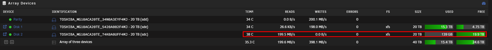

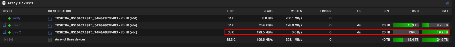

Setting it to this, did not help.ย
During move
After move

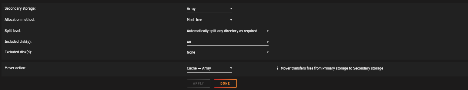

But will try with High-water and split level "at any level"
I do have Mover-tuning plugin running, does that matter ?
With these settings
Don't really want to move everything off cache, so doing 5% drop down, while testing.
