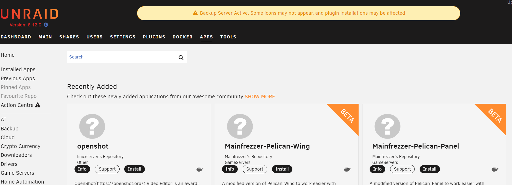

Backup Server Active. Some icons may not appear, and plugin installations may be affected

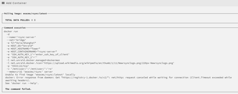

Recently, I could not install any docker app in which 0 byte of the image files could be pulled.  On the top of apps' field, there always is an alarm says "
I don't know what happened. Could anyone give me a help and thanks.

CA isn’t up to date as that message doesn’t exist anymore.
but the reason for it was that you are unable to pull anything from GitHub which may also affect your docker pulls
set static dns addresses in network settings to 208.67.222.222 and 208.67.220.220

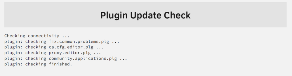

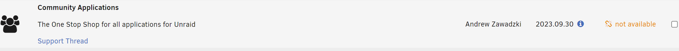

How to make CA up to date? What's the newest version?2024-12-26220231.thumb.png.b97292b480e9c295b5dac7ed835c3f71.pngimage.thumb.png.703087f29116c511076da5e6ba9e00ff.png

Since it looks like you're on 6.12, latest version is 2024.12.20
If checking for updates doesn't fix that up, then you're still not hitting GitHub properly.  Post your diagnostics

CA is up to date but docker installation was failed.image.thumb.png.4e46dc2b4d1581b2de3b9c965181efd4.png

I can reinstall transmission but cannot install rsync-server.
