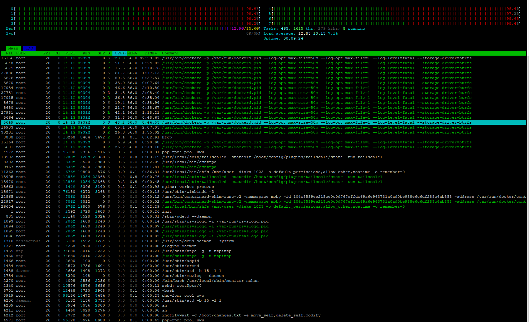

Update: I pause all dockers and server would become unresponsive a couple minutes later.
Just seconds before it becomes unresponsive I saw the read on Cache drive and flash drive read spiked and CPU increases.
I was able to see the processes through putty for a minute or so, but unable to get diagnostics. See attached.
There are multiple proccesses of:
/usr/bin/dockerd -p /var/run/dockerd.pid --log-opt max-size=50m --log-opt max-file=1 --log-level=fatal --storage-driver=btrfs
