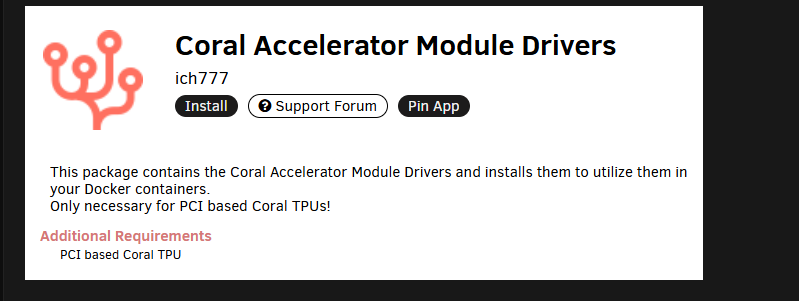

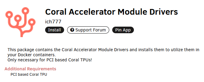

December 29, 20241 yr Community Expert unraid is slackware linux. ich777 has a plugin to install coral drivers. driver for unraid require a plugin.

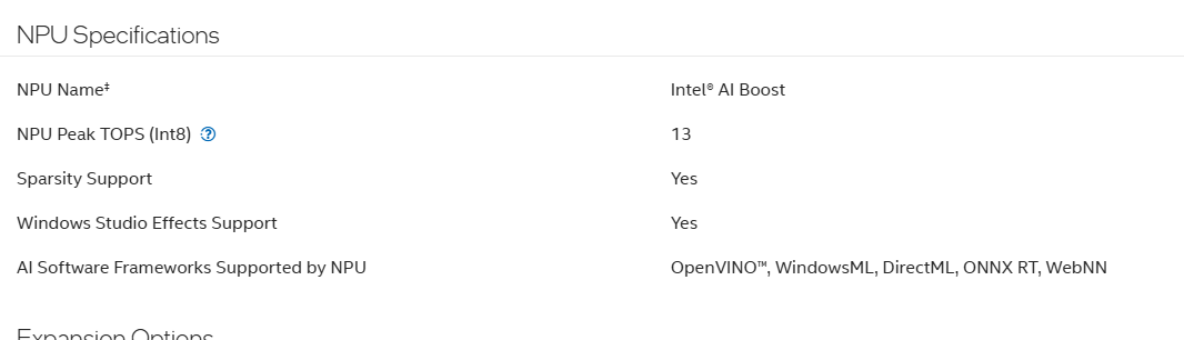

September 17, 2025Sep 17 Community Expert 17 hours ago, Benji7790 said:Hi, I bought a Core Ultra 9 for it's NPU. So you are telling me that at the moment this is not possible to make it works in unRAID ?you can pass it into a vm and use a vm on a differnt OS.I'm not sure of all the drivers and support for theses devices. That's more ICH777 area and his driver plugins that use and support this for use in things like frigate docker and Home assistant. as an example...As unrad runs on x86_64 with slack ware linus. if i'm understanding you havehttps://www.intel.com/content/www/us/en/products/sku/241060/intel-core-ultra-9-processor-285k-36m-cache-up-to-5-70-ghz/specifications.htmlif the chip supports x86_64 instructions, then it will work in unraid/linux...in order to use these additional chipset and instruction, the kernel needs to load them... (they may not be loaded by default...)at this Time, I'm not 100% sure if unraid supports them or not... As this is a IT software and hardware specific issue and your results will vary....However, Ive used and seen some npu with dockers on unraid...) the intel plugin and docker that support and use openVINO will use and benefit for having a NPU...in general this post was referring to the Coral applications and existences of npu drivers that already exist at the kernel level. it more of what dockers have support and can use and benefit from the npu.and someone wanting to load additional npu to the host which is not possible outside of a drive plugin. (that may or not be needed) or script loading additional software....as this is more cpu instruction sets and the processor support npu.... its not realy a question of does unraid use and can use it but whats your intent and how are you running xyz that may or may not use the npu...these npu are additional addons that can help with AI and other task that use the added processor instruction set... some npu are built into the cpu....the host unraid problem still lies in the need for a modprobe to utilize the npu on the host...https://www.reddit.com/r/linux/comments/1dkqwf6/is_there_any_use_for_a_npu_module_on_linux/which is why I informed of the plugin drivers:An example of a Linux compatible NPU is Google Coralhttps://coral.ai/products/accelerator/which others on the forum have used and have used with unraid on the forum with face identification in frigate. with out knwoning more on the NPU I can't say one way or the other...so the question is more what npu hardware are you running and does unraid slackware liunx have a kernal level modprobe driver for that hardware... otherwise a driver may be needed depending on how you use and will use the npu...
