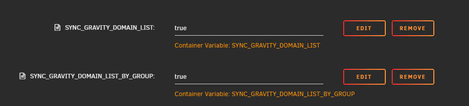

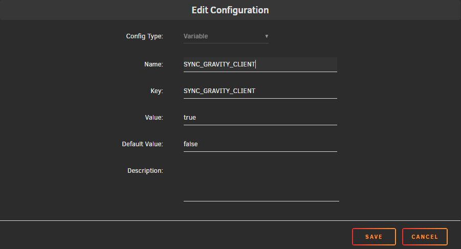

I want to do a partial sync. Docker in unRAID is not intuitive. How do you add the variables for the sync options?
Thanks!
Thanks!
add each variable manually as part of the docker settings (see attached). I kept the name the same as the key for consistency, but the key is the actual variable name.
also make sure nebula and pihole are on the same docker network. That bit me.

yes that's one way.
I would love to learn other ways to add variables. Unfortunately most documentation assumes that one already knows how to do everything.
