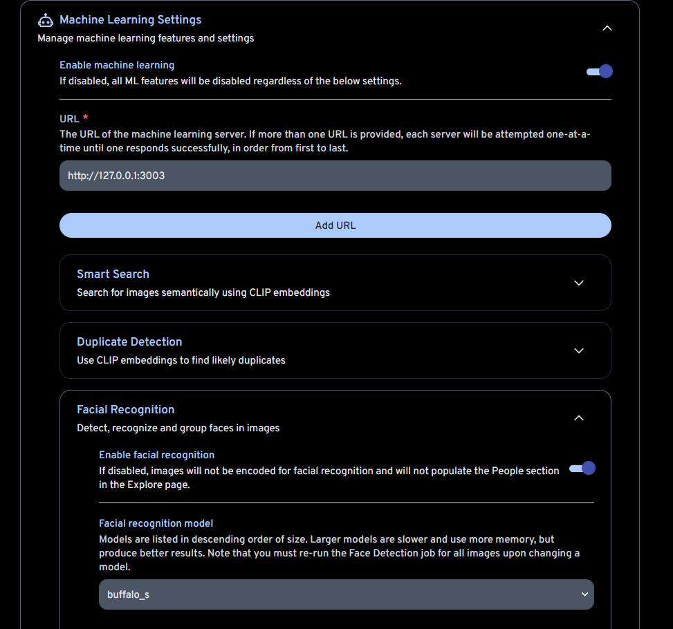

having jsut turned the back on you may neeed to go to immich administrator settings and use bufallo_s
