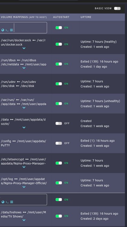

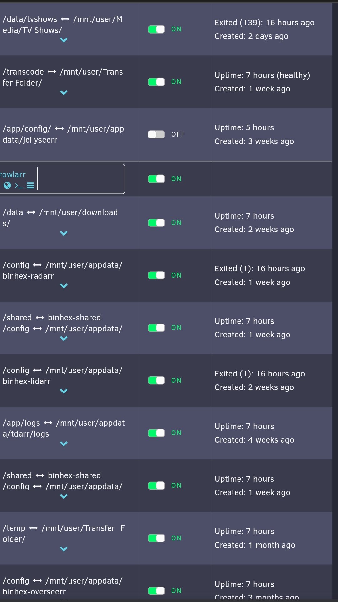

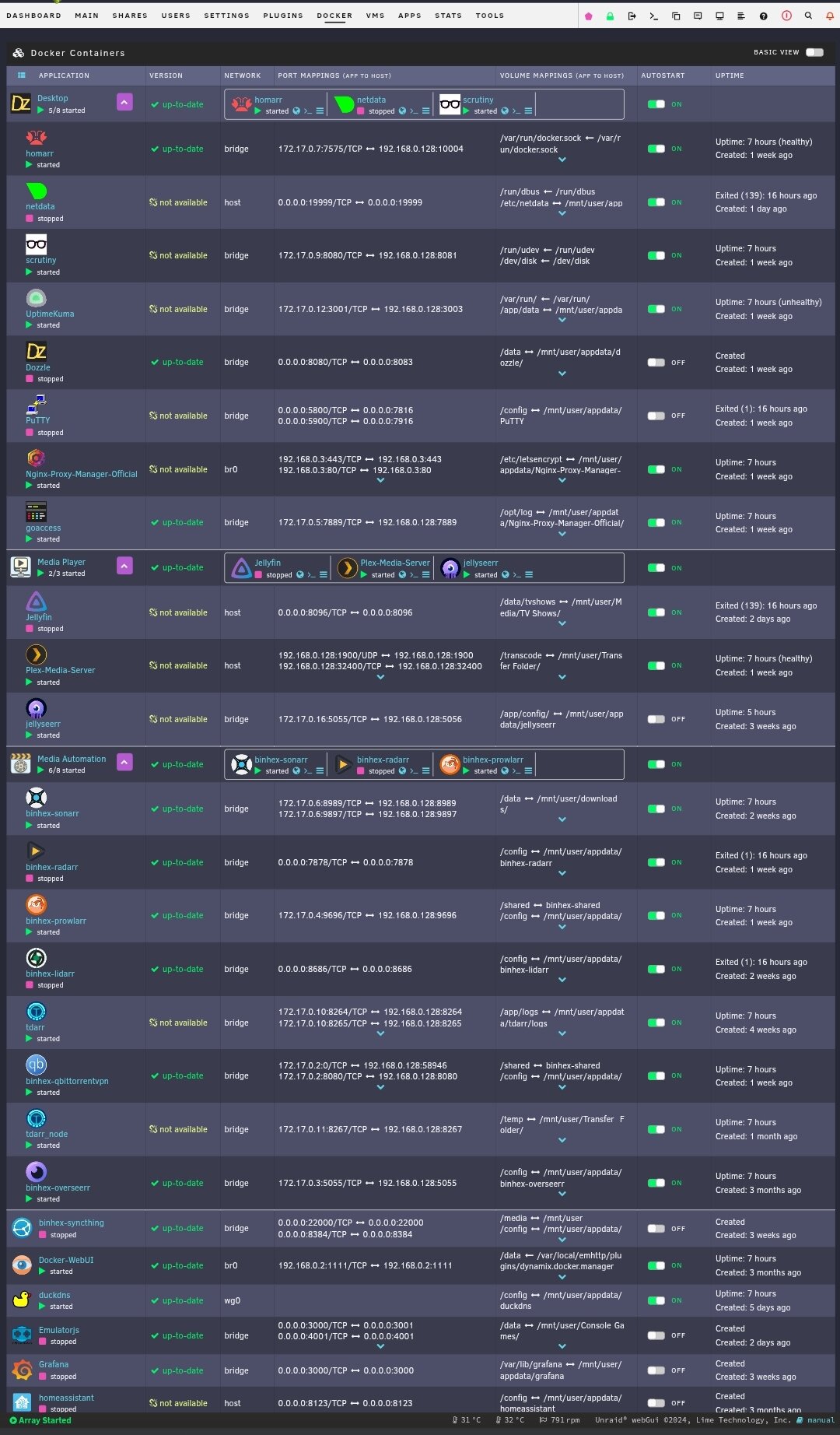

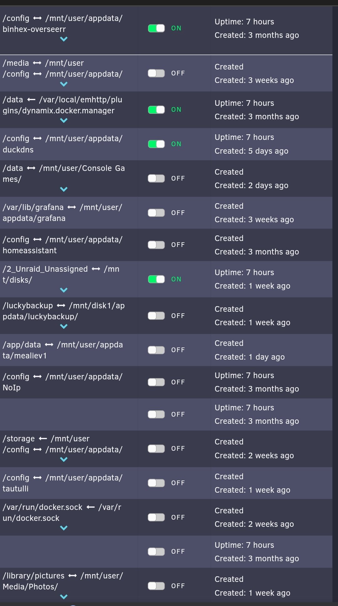

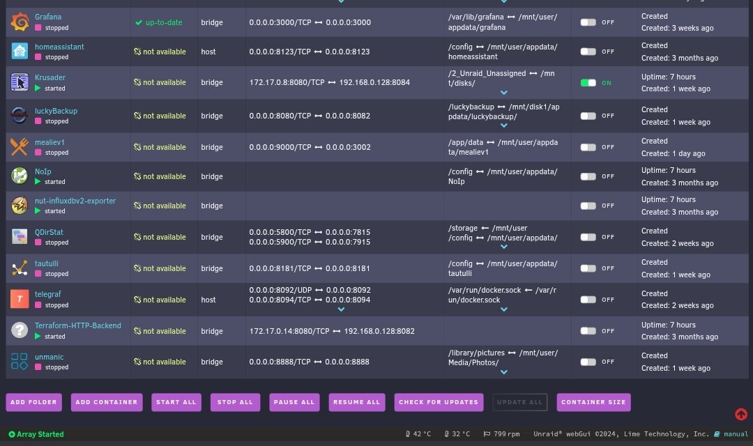

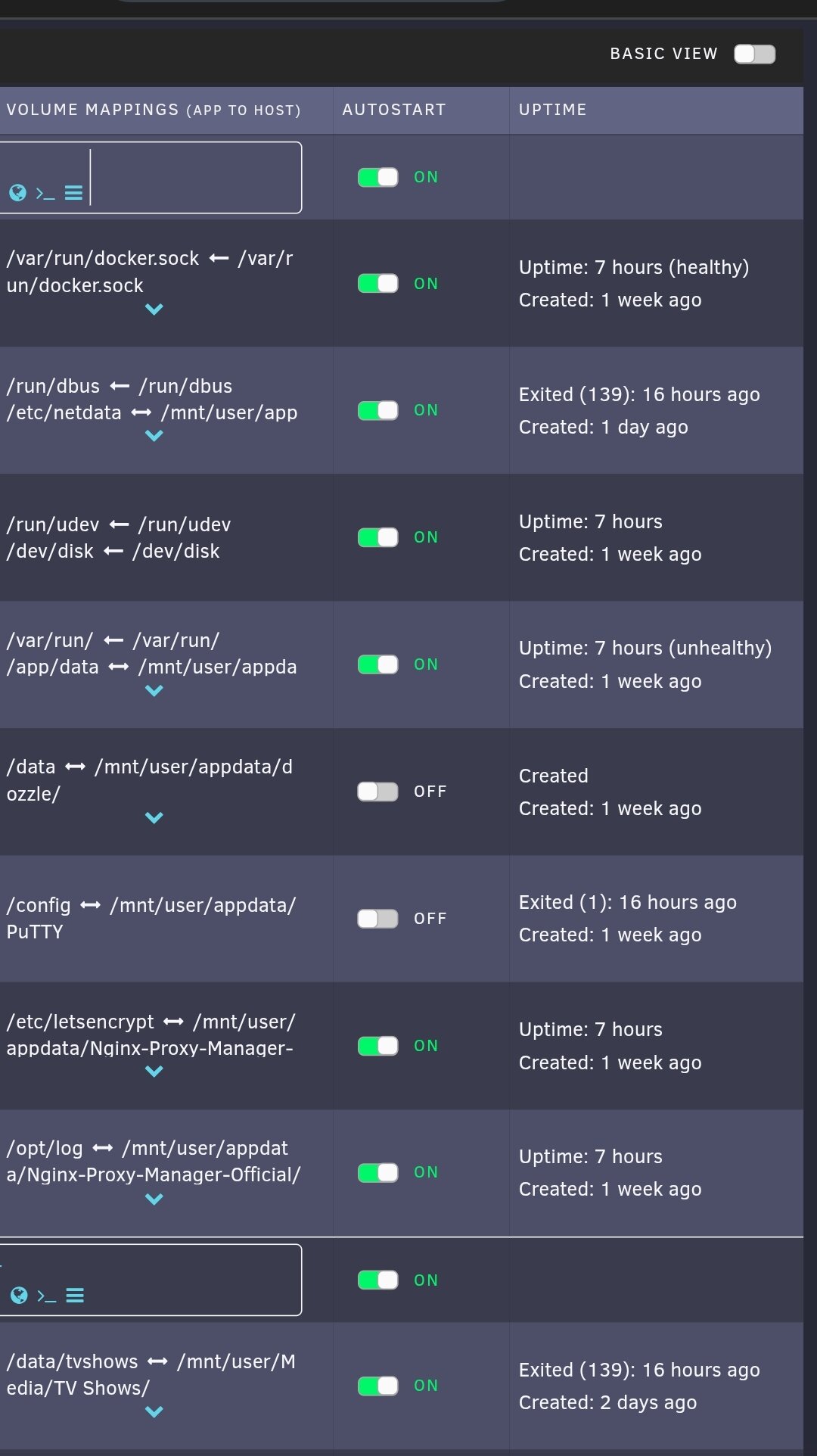

Hi Jorge,
Here are a few pics of the containers uptimes.
To me it doesn't seem to have anything unusual. Screenshot_20241229_103504.thumb.jpg.c93d9080dbd7e1fd503ce6569960597f.jpgScreenshot_20241229_103545.thumb.jpg.d864d7556b4b1ce0cac8e1baf8399d5d.jpg
Edited by Yannoviche
Possibly, they are not even starting, check the container logs for the ones that don't start, you can also try recreating the docker image:
https://docs.unraid.net/unraid-os/manual/docker-management/#re-create-the-docker-image-file
Then:
https://docs.unraid.net/unraid-os/manual/docker-management/#re-installing-docker-applications
Also see below if you have any custom docker networks:
https://docs.unraid.net/unraid-os/manual/docker-management/#docker-custom-networks
