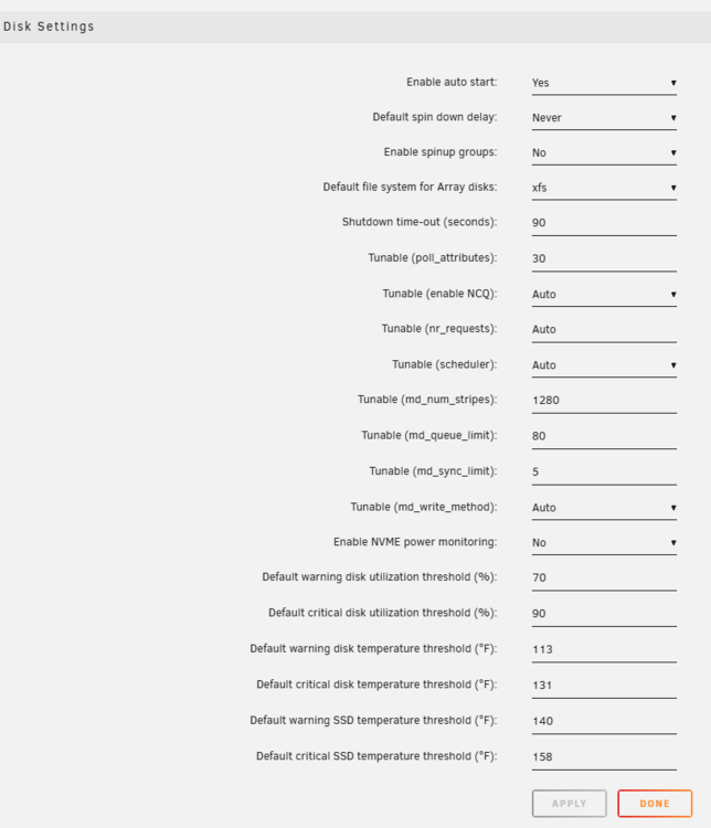

Settigns > Disk Settings
What are your options for spin down and time-outs.
Your correct if something like pihole as it does have constant reads and writes. if this data folder is on the array the disk will be kept spinnign to handle all of the read and writes.
Is Turbo Write turned on?
I also noticed your isos share on disk1.  Suggest moving that to your cache.

Thank you for your responses, Found controller in IDE mode. Switched to AHCI and all back to normal. Thank you.
