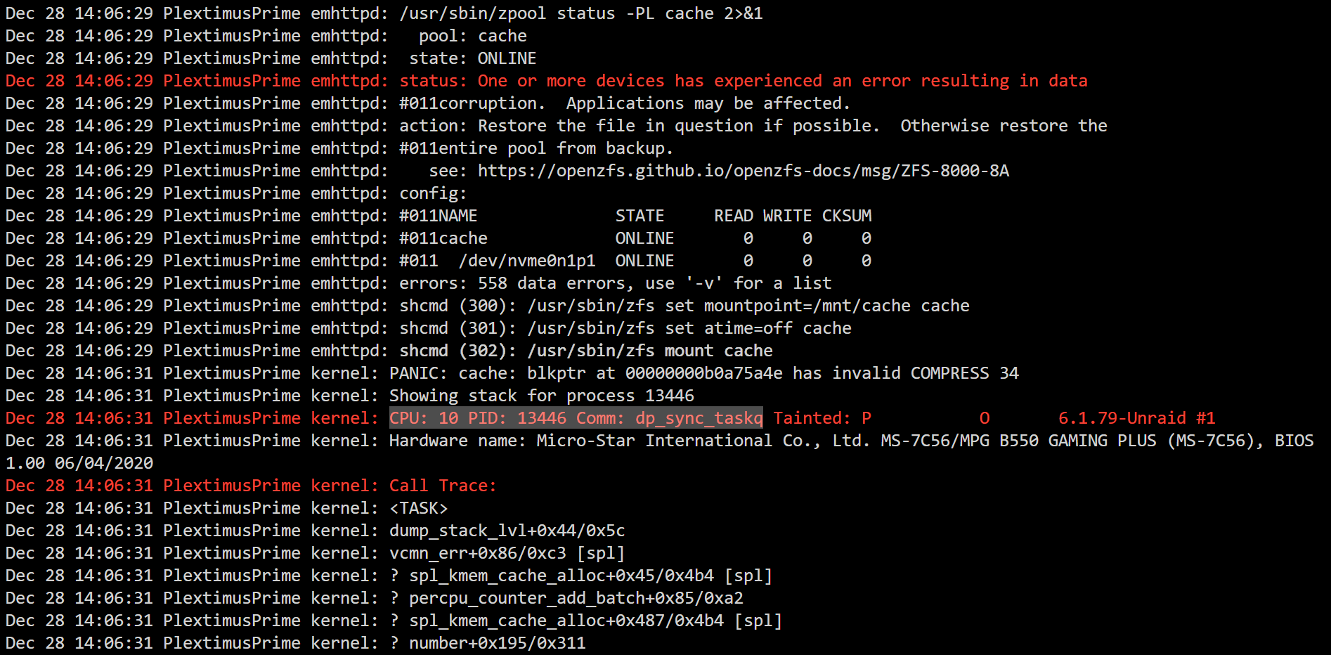

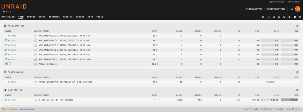

I was having issues with my dockers crashing and believe my radarr database was corrupted so I decided to make the Docker vdisk size bigger and recreate it. Since I was going to recreate the docker.img anyways I decided to take the opportunity to change the docker from btrfs vDisk to xfs vDisk while also expanding my size from 40gb to 65gb. After creating to docker.img I tried to reinstall my dockers but only one installed and the rest were giving me errors so I tried to restart the whole unraid server but it was stuck on Stopping Services so I restarted it by pushing the physical power button. However, after rebooting I can not get the array started as it gets stuck at "Array Starting - Mounting Disks...". Any help would be greatly appreciated. I have posted my diagnostics as well as the error logs I get at boot and my Unraid "Main" page if you need anymore information please let me know. Thanks in advance.

There's a problem with the pool filesystem, see if it mounts read-only:
zpool import -o readonly=on cache
If it works, start the array, the pool will show unmountable, but the data should be under /mnt/cache, then backup and reformat the pool
