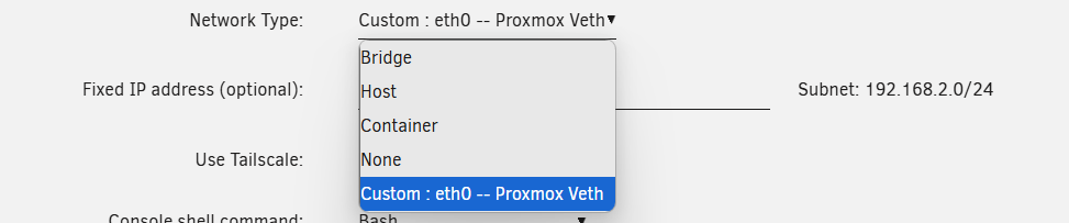

December 30, 20241 yr Community Expert diag is only part of the picture. sadly the daig for security won't grab some docker stuff. which plex docker? I use: linux servers lscr.io/linuxserver/plex settings docker: I use macvlan ipvlan is ok here, but toggle advance and enable preserverr and host access I'm on v7 rc2 stable 6 is fine. you should be using custom: yours may say br0 it could be custom br0,bond0,eth0 depending on your unriad network settings. I have bridgin and bonding off.. with custom you static set a ip address to the docker as it it were its own machine. not the subnet my network dhcp router is 192.168.2.0/24 so i would need to set a static ip of 192.168.2.2 per example plexe webui would then be at 192.168.2.2 in bridge mode its at unraids ip but it apears your have a port conflict. try custom interfacename
