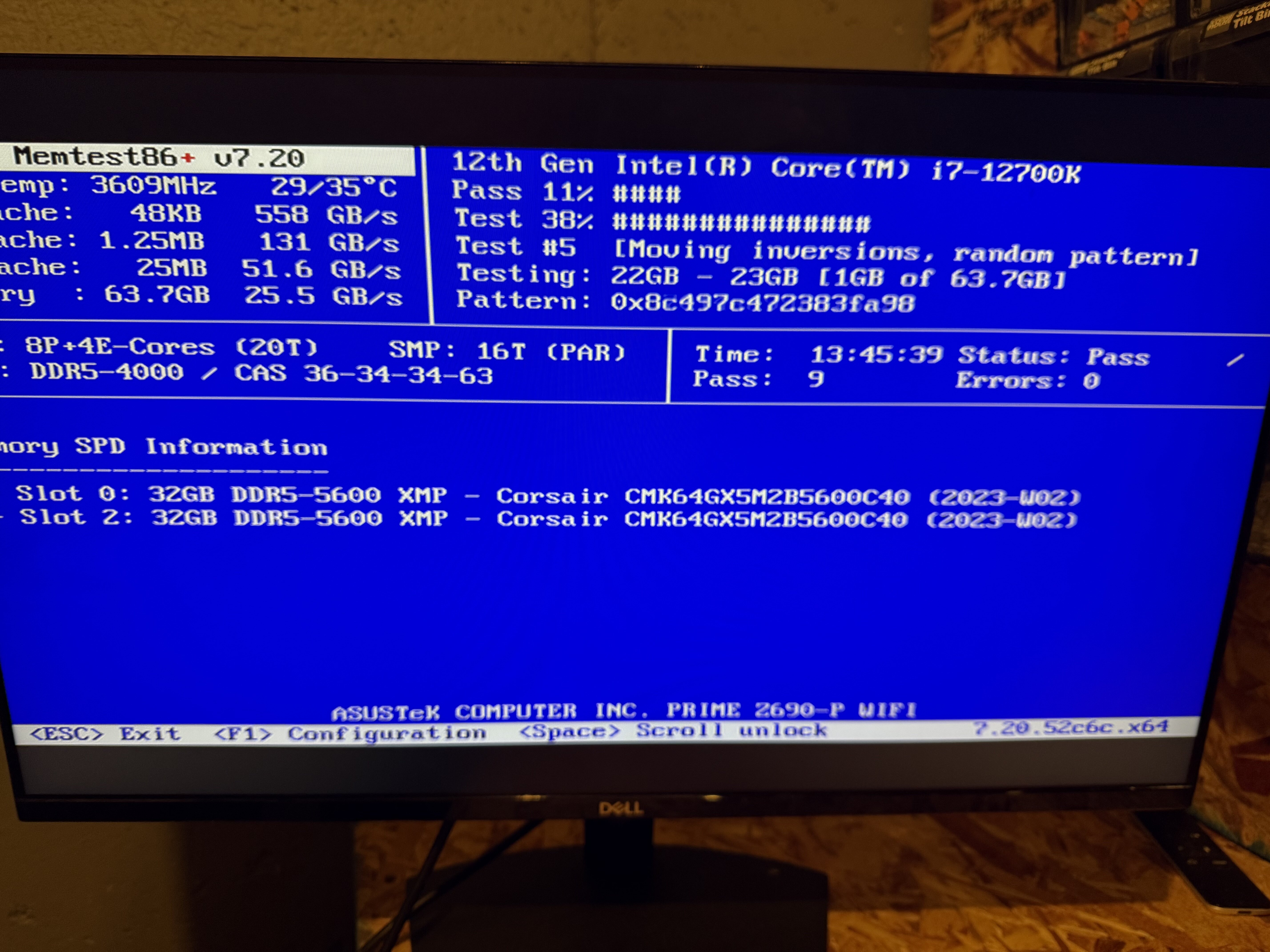

Btrfs is detecting a lot of data corruption, start by running memtest.
no issues found with memtest.

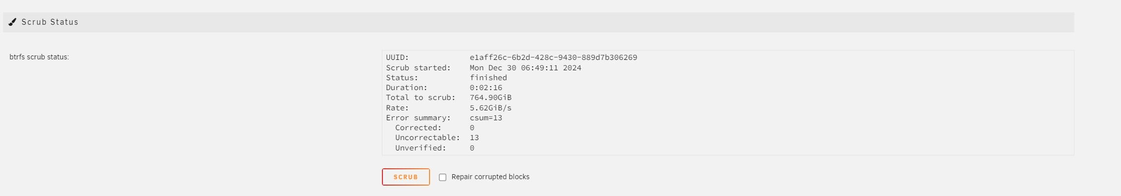

Run a correcting scrub on the pool and post the results
Thanks.  Here are the results
Edited by jonathonmccoy
Copy all.  Files deleted, scrub complete with zero errors and i have reset the filesystem stats.  I appreaciate your help.  Before I walked away from it, i was crashing often.  Am i correct in assuming that this is a result of that - and not the cause of the crash (meaning - non responsive).
