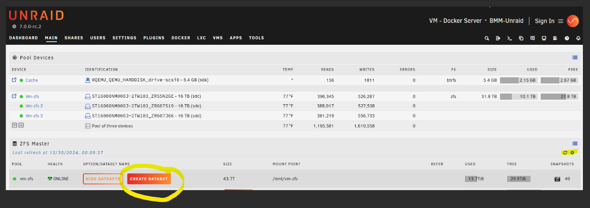

7 minutes ago, bmartino1 said:
But yes this compression is possible. Usually done with the zfs master plugin at the main screen when making a data set.

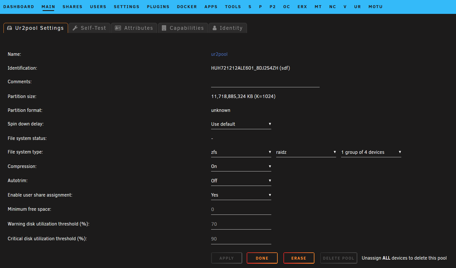

  Where do you see this page?  I'm not seeing it.  I have ZFS master installed, and I see the following:
I got here by hitting "Add Pool" (below).  I didn't see any options under ZFS Master to create a new pool, so I did it via command line.

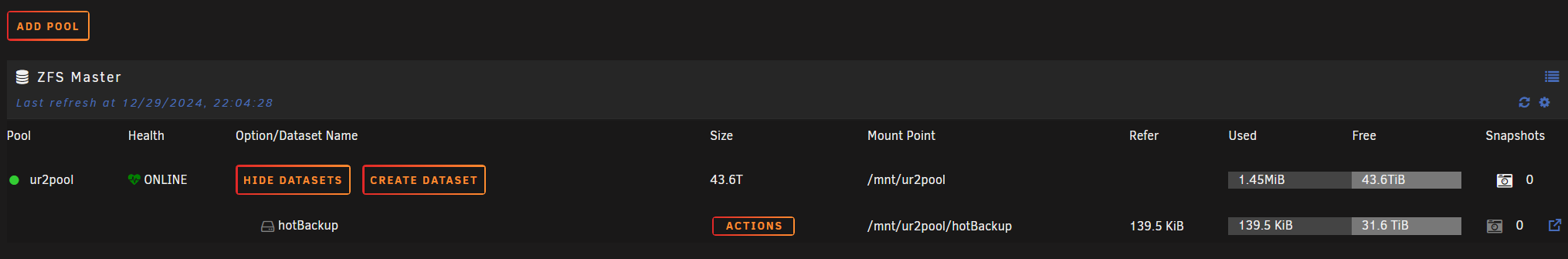

The zpool then showed up under ZFS Master:
What am I missing?

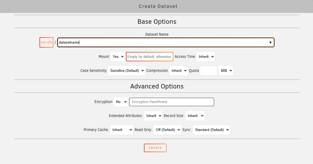

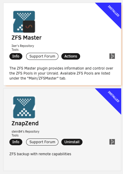

under the main tab.
its a plugin

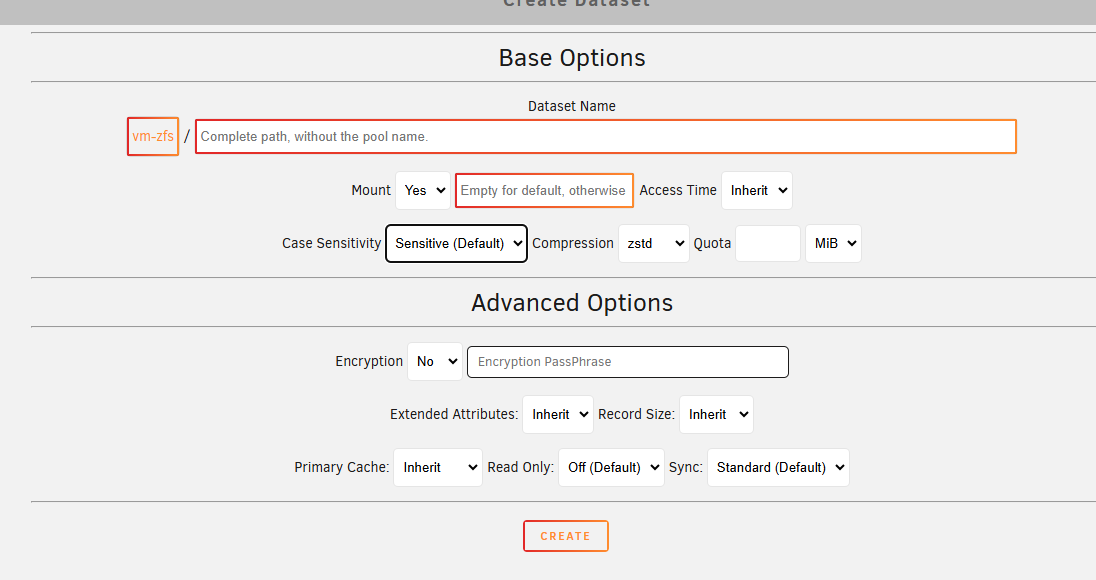

Ahh thanks again @bmartino1.  I'll delete the dataset I created via terminal, then recreate it via the GUI.  I only see the basic zstd, but no option to set zstd-5.  Is there a way to set zstd-5?
Edited by calvados

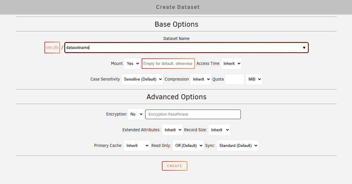

so the compression is zstd the quota is 5 MiB per the zfs plugin to set that option.
you may also need to set each disk in the unraid web ui for the zfs pool for compression on:
then in the dataset creation:
its been a while.

Getting closer.  I followed these steps and now I'm getting:
zfs get compression
NAME               PROPERTY     VALUE           SOURCE
ur2pool            compression  on              local
ur2pool/hotBackup  compression  zstd            local
Any other thought as to how can I get zstd-5 or another zstd-# compression?

Turns out this value "5" should not be set, as it is the quota for the dataset:
Thanks, Its been awhile, I didn't think that was right as trying to set a compression level.
