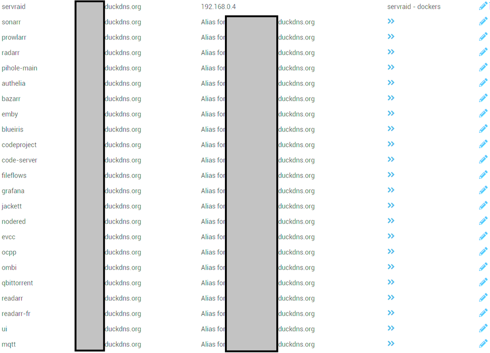

PFSense as router, firewall and dns resolver. In PFSense, I have multiple alias for my domain:

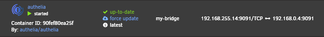

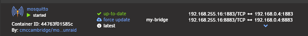

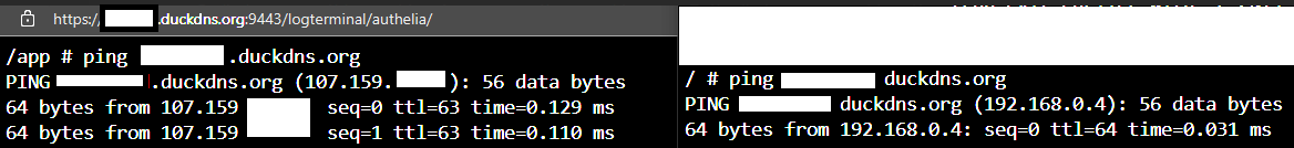

Now, when my docker boot, if I ping into a terminal session, some will resolved to the external ip, others to the internal ip. For exemple, authelia on left, mosquitto on right
Both are using my-bridge as connection

PiHole is already up and running in the stack, but it's also already running on the 2nd server. Even there, I can close piholes on both server and dockers will still work since I'm not using pihole for the dockers but my pfsense. So I don't get why it resolved to the internet ip when everything point to a local ip...
