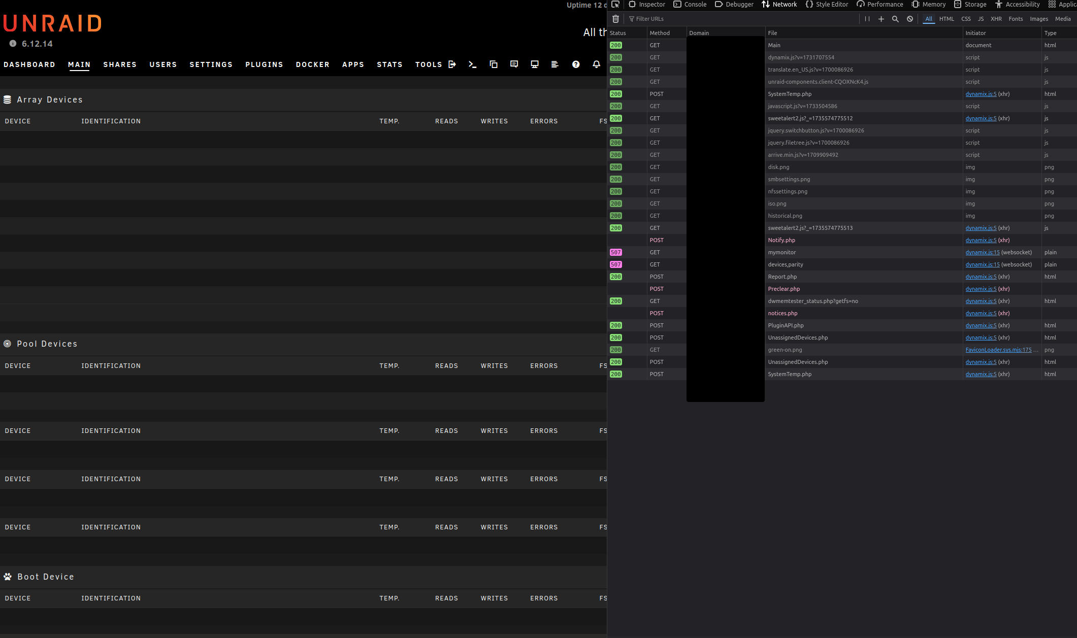

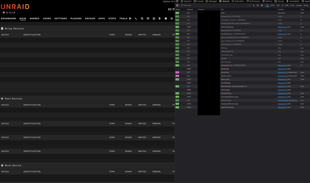

UI stops displaying data at random
Dashboard and Main both stop displaying information at random.
Docker, tools, settings all work fine. just seems to be anything with "live" data just stops working.
looks like i havnt gotten syslogs since dec 20th. this message was basically spammed in the syslog for about 12 hours then nothing else since.
