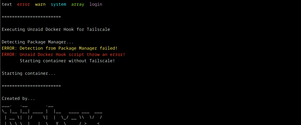

I have a Tailnet with all my devices in it, including one of my Unraid servers. I am trying to implement Tailscale into a Jellyfin container (following Spaceinvaders YouTube 'The Ultimate Guide on Unraid'). I activate Tailscale in Edit, give it a name and save it. Now I need to look at the log to get the IP to authenticate the service, but what I get is the normal log that shows the start of Jellyfin, obviously without the necessary link.
I have added Tailscale to 3 containers on the same server without a problem, just Jellyfin resists to show the right log with the link. Is there another way to get to that link? Is there a known reason why Jellyfin would resist? The process is so awesomely easy, that you basically can't go wrong.

Please post the file which is generated by (execute this form a Unraid Terminal, NOT the container Terminal) :
docker container logs binhex-jellyfin > /mnt/user/media/jellyfin.log
(you'll find it in /mnt/user/media/)
In the Jellyfin logs is most likely going on to much at startup so that you won't be able to see why Tailscale isn't working.
@linuxdevil, I've already received the jellyfin.log, can you please also send me the docker run command?
EDIT: I had now a bit more time and tested it myself:
Seems like `which` (a basic tool from Linux) is missing in the container which seems rather strange to me, you have now two options:
  1. Go to the support thread from the container and ask the maintainer to include `which`, maybe @binhex can add it
  2. Use the official Jellyfin container
