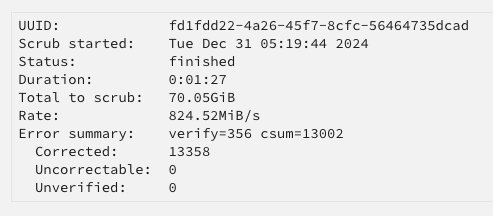

Quite a few. Scrub was never run AFAIK. I've scheduled it to run regularly now.
All errors were corrected, that's good, but the docker image is corrupt, you can recreate it:
