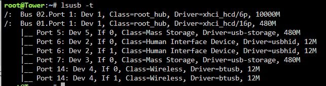

lsubs output shows the devices are linking at USB 2.0 speeds (480Mbps), hence the low performance, are you sure you are using a USB 3.1 port? Bus 02 appears to be the USB 3.1 port (10000Mbps).

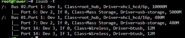

I've now been plugging the enclosure to different ports and I finally seem to have found one that is actually USB 3.0. I don't understand, why some were recognized/are built as USB 2 - according to Lenovos M720Q manual, that model exclusively has USB 3.0 and upwards.

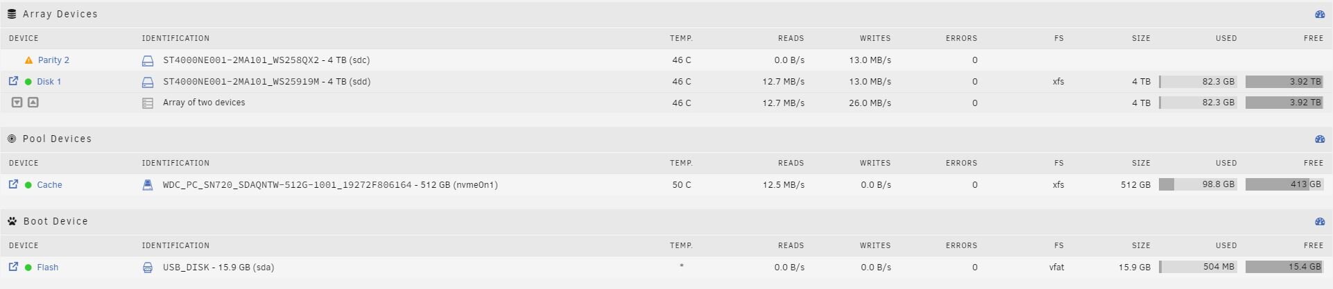

I have parity speeds ranging between 140MB/s and 180MB/s. Is that to be expected, or should that be higher?
Currently my lsusb reads as following:
Can I assume, that everything now works as expected?
Looks OK for USB, never as fast as SATA usually when using multiple devices.

Is there any way to figure out, which device is connected to which port, for future troubleshooting, should it happen again, when I plug in more drives?
lsusb -t
together with
lsusb
outputs should allow you to see which is which
Thanks, that seems to be a working solution for me now!
