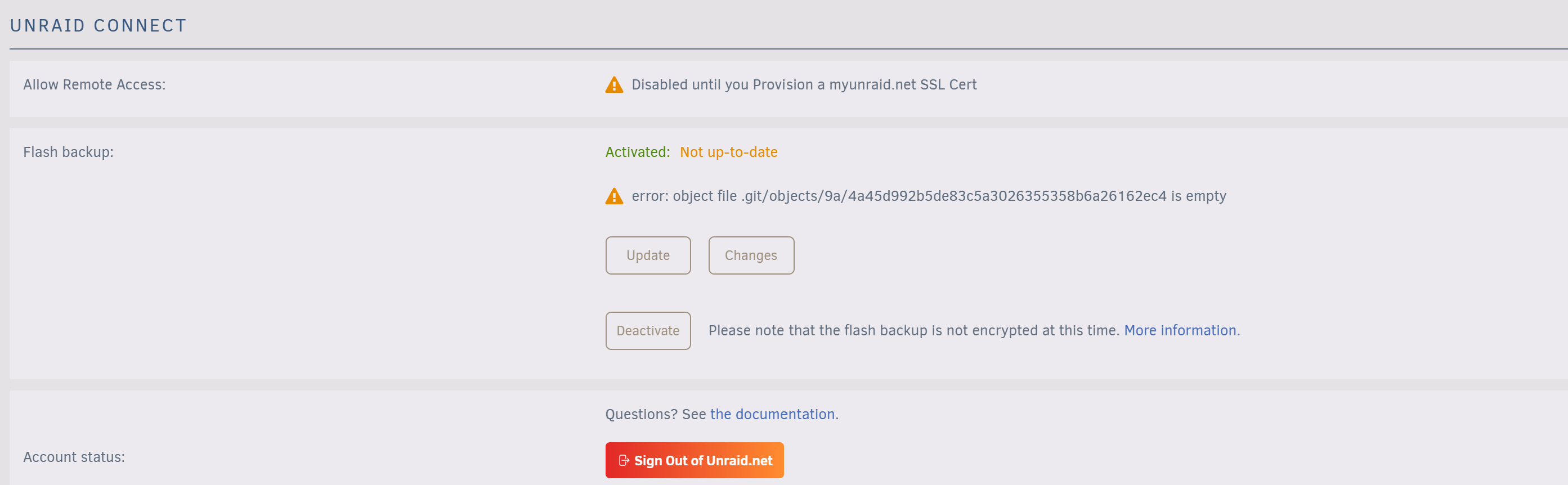

Cannot make an unraid connect backup due to "error: object file .git/objects/9a/.... is empty"
I have an issue where I cannot make an unraid connect backup due to this error,  Does anyone know how I can get rid of it?
I tried using git --help for some sort of repair commands or something but nothing stood out as what I need
Thank You,
Edited by gghost42
more info

Hey, try deactivating the unraid connect, restart your server and try to set it up again, I believe that resolved it for me a couple months ago, it seems to imply that the empty git object is some sort of random empty file but I think it is directly related to the unraid connect function
@gghost42 welp that's what I was trying to do, but things went terribly downhill from there. I wanted to deactivate, but before that I noticed that there was an update for Unraid Connect, so I started it. It somehow bugged and stopped working. All of a sudden no plugin could be updated or installed due to "pending installation".
Restarted my server, and couldn't boot up. I run a scandisk (win 11) on my Unraid USB key, found no errors. Started in safe mode, everything was well - than rebooted to normal mode and everything went "almost" back to normal.
Almost, because Unraid Connect (which was reporting as "not installed") couldn't be installed. Tbf, no plugin could be installed either.
I already had backups for everything, so I took the short path and installed 7.0.1 from 7.0.0. Everything went well and I was able to reinstall Connect and every other plugin. Still, the smame error is showing up... But at least I regained control of my server.
Ok, it looks like your solution was right! I deactived it, rebooted and reactivate, and now everything looks up-to-date.
I'm still occasionally having the bug whenever I try to update a plugin, it won't open any popup and it won't do nothing tho. Might be a DNS issue? But that's for another topic...
