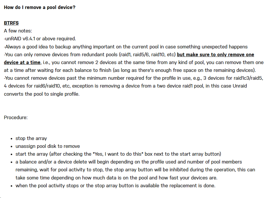

11 minutes ago, JorgeB said:
Pool mounted and seems OK, to remove a device you first must rebalance to raid1, click on the pool, scroll down to the balance status section, and convert to raid1, after that, you can follow this:
https://forums.unraid.net/topic/46802-faq-for-unraid-v6/#findComment-480418

That link if for removing a pool device, but basically, and after it's balanced to raid 1, you just need to stop the array, unassign the device you want to remove and start the array:
