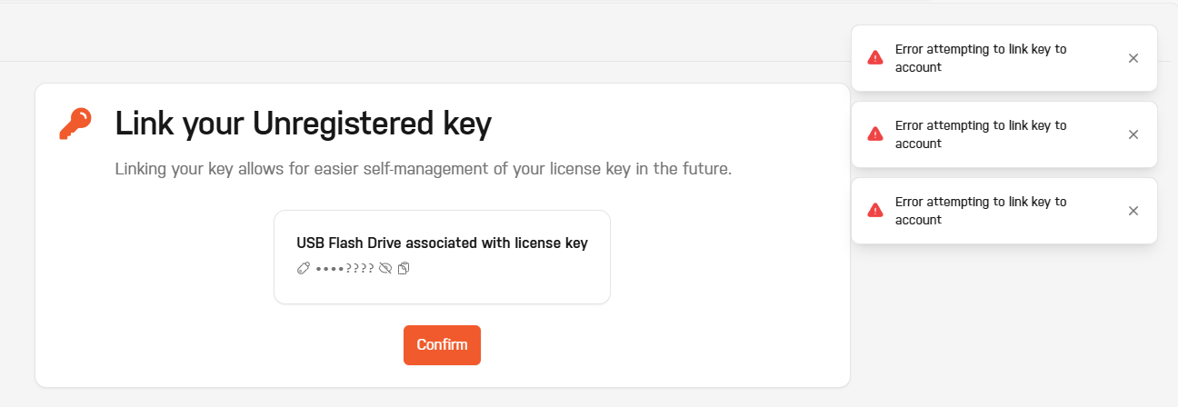

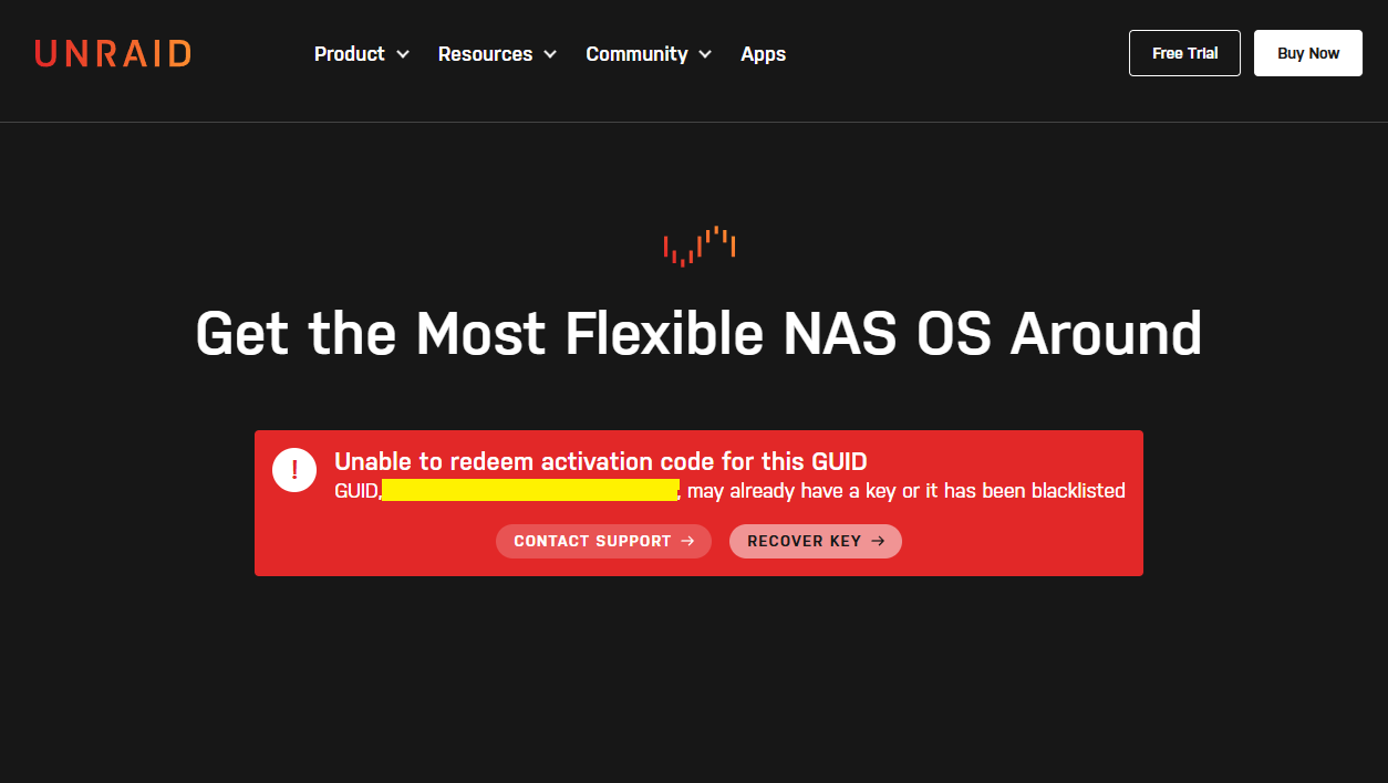

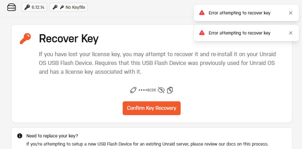

I purchased unRAID (never done a trial, so not upgrading from trial) and I can't link the key from my USB to my unRAID account.  I already used the creator to make the USB, created a root login/password, and booted from the unRAID USB stick. However when I am trying to set things up, unRAID recognizes my USB and shows that I have a key but it doesn't link them.
Any help would be appreciated. I'm not technically inclined but I have been troubleshooting for a while to no avail.
I used an Anker 2-in-1 USB 3.0 Portable Card Reader with SanDisk 32GB Ultra microSDHC UHS-I Memory Card unraidproblem2.thumb.png.c12754c9f2b98356f56ec74b13f20828.pngunraidproblem1.png.fe739de8c7e1cd64af651579fdc9e8b6.png
