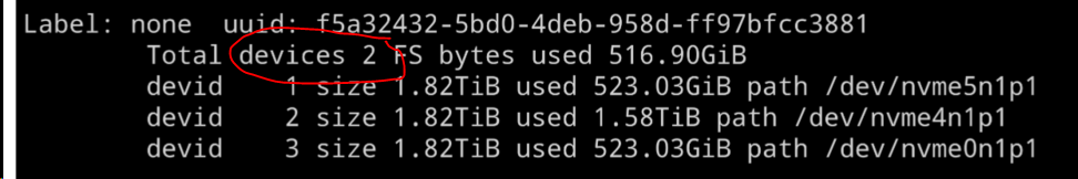

Post the output from
btrfs fi show

Attached. Thanks!
There's an issue with this pool, it should only be 2 devices but it's showing 3:
Probably one of them was used before with the same pool, if you know which device that is (possibly nvme4n1?), disconnect it and post that output again.
Physically removing the prior NVMe device appears to have fixed the issue. I have also attached the output following the removal of the NVMe device. Thank you for the idea!
However, I am still trying to understand this. The device I removed wasn't added to any pool. Would there be a way to remove this device from the btrfs pool history to prevent this from happening again? My hope is to somehow wipe the old NVMe and try to get some use out of its remaining life.

See if the pool mounts normally, now, if yes, just wipe the other device, you can do it with
blkdiscard -f /dev/nvmeXn1
This worked perfectly. Thank you so much for the help!
