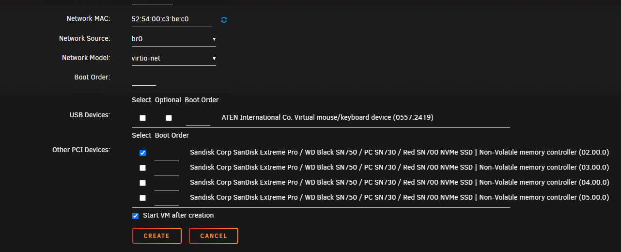

Can you provide a view of the template gui options as that path does not look correct to me
The option is not available for choosing.  The SSD is m.2 Adata 1 TB.
Edited by jang430
Assign the SSD to a pool, and it will be.
I intend to use this SSD for gaming, therefore, I prefer passthrough to get the most out of the performance.
In that case, you pass through the NVMe device on the VM, assuming it's on its own IOMMU group, bind the device to vfio-pci (Tools - System Devices) and then select it in the VM form, e.g.:
And remove the vdisk entry, you just select the device here.
I believe that's what I did, not removing the vdisk entry though.  I will do it again and try save some screenshots while I am at it. This time, will try without vdisk entry.
Edited by jang430
Remove it and try, or at last without inserting the path you were using, that doesn't look valid to me.
