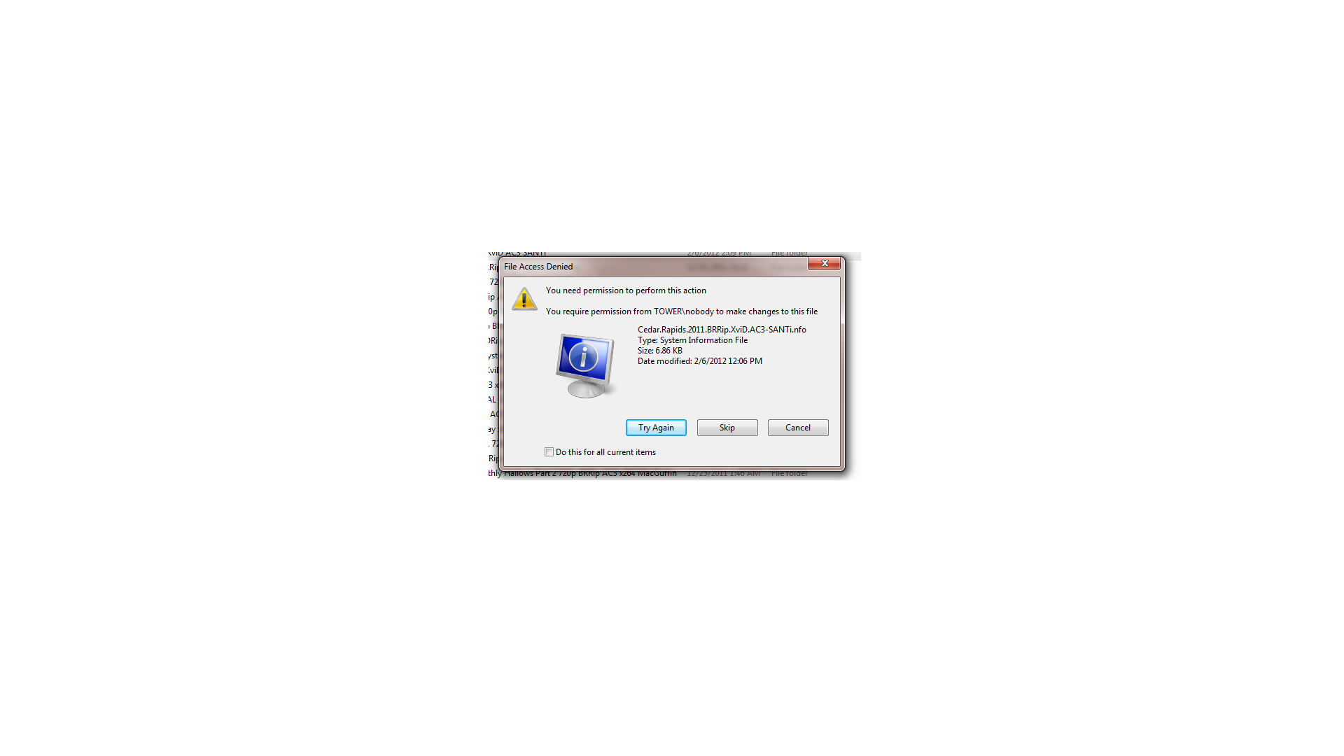

I really hate to ask for help for such a trivial problem but I am having a real hard time to fix this annoying problem. I used Midnight Commander to transfer some files from a USB drive to the Unraid server running 4.7. No problem. But when I upgrade to the Unraid 5B14 I suddenly found the I can no longer delete, change my files. Instead I was greeted with a popup window saying " You need permission from TOWER\Nobody to make change to this file."
Now Joe L, the Unraid Guru posted that the solution is to run "chown nobody:users THE_ENTIRE_DIRECTORY_HERE" and that would solve my specific problem.
Well I did that and also ran the Permission Utility and nothing. Same Popup. So I just let it go since I can use MC to remove the files.
CHOWN changes the onwership of the file to nobody. But I need permission from nobody to change file. So Windows is not allowed to change file because it's not Tower/nobody. How do I get permission from tower/nobody.
But being a persistent kind of a person, now a few months later I tried again with different files and wasted a tremendous amount of time doing it and again, nothing happened. Joe L is very knowledgeable. But I cannot figure out for the life of me what did I do wrong?

That's how I understood it. chown nobody:users (directory or files) should have fixed the ownership issue. I did a ls -l to verify and indeed nobody is the owner and users the group.
See the attachment above, I need permission from NOBODY to Write to the file. So I did a chmod og=rw that should have given permission to RW to others and users. But it did not fix it.
I also ran the permission script with same results, i.e. Need permission from nobody.

This is a known problem with the Beta and its new security - public folders do not get the right permissions set.
If you have  a user create a file/folder in a public one, the new file/folder gets the user's permissions (owned by user) and then any other guest/public user can not interact with the file.
I've logged this behavior in the 5b14 thread, so hopefully Tom will fix it in the next beta.
@marcone, thank you for bring this problem up to Tom. This is not a major problem since there are workarounds. The permissions do indeed get messed up in certain transfer modes (not all) but they can be fixed. It just bothers me that very few people, supposedly, knowledgeable experts, have dismissed this problem as the fault of users who should have known better.
