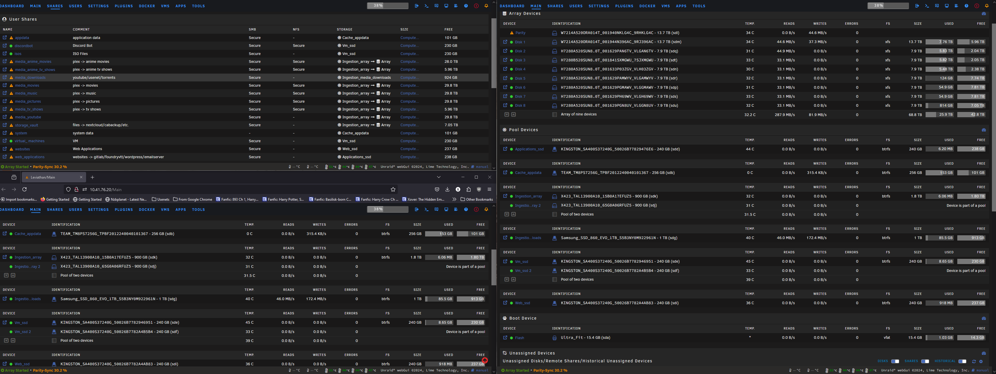

Hello All,
Having a weird issue and I can't see, to quite figure out what I did that started it. I have attached a snip from my desktop.
Basically, I have my media downloads going to a 1tb SSD called Ingestion_Media_Downloads. Once the files are processed they SHOULD move to Ingestion_Array ( 2 x800gb 15K platter drives) and then at 3am they will move from Ingestion_Array to to Array for final storage and Parity. However as I was redoing my dockers this AM, I noticed while it was doing a parity check, that my Ingestion_Media_Downloads is working, but the files are writing straight to my Array and not to the Ingestion_Array. Would anyone happen to know what setting I may have borked for that? Because the Share drives are still showing "Ingestion -> Array" as they should.
Thanks for any help.
-Hal

What is set for the Minimum Free Space setting? Is it more than the free space on the pool?
You are likely to get more informed feedback if you post your system's diagnostics zip file so we can check how you have things set up and to view logs.
