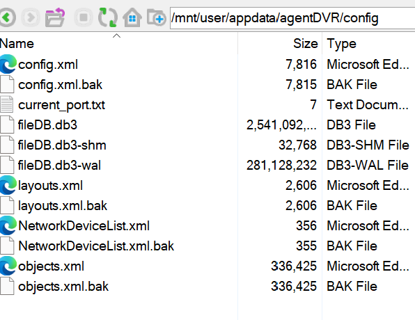

I am running two different instances of agentdvr on two different Unraid servers. Both are set up identically and have worked great for a couple of years. I recently reduced my array on one of my servers and it seems that during the new config build something went awry with my AgentDVR docker. I no longer see that system listed in ISPYConnect. and I can not log into it locally. I do not see a users.json in the config folder and the config.xml shows the password 9IWE/21mLrEXRE/AoqZkHk== and that is not working.

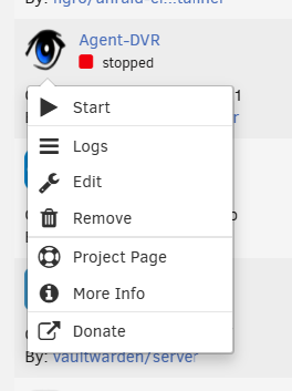

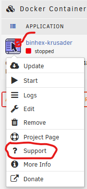

Look at the Docker container in DOCKER.  Left-click on the Icon (To the left of the Docker name).  Does it have a Support option?  If so, click on that and go to it.  Hopefully, the support thread will be useful...
I finally did find it listed in the Community APPS plugin and there is a support thread.  With a quick search, I did find how to reset the local password.  When they are talking about opening up a console, they are probably talking inside of the Docker Container.  If there is one provided, it should be listed in the dropdown menu.  (The one that I pasted above does not provide console access.  There is also a Community forum on that website, so if you can't figure things ask there. )

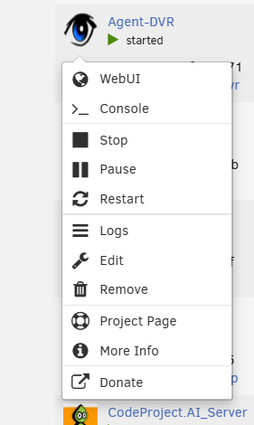

Thanks Frank,
I thought the same thing; my issue is that there is a console in the docker when the docker is running, but stopping the docker as the directions states stops the console as well.
I am trying to dig through the support docs, but unfortunately, the documentation I see does not match the information I see when I look into the data.
If I open a normal terminal and CD to the agent DVR folder, there are two folders inside of it: a commands folder and a config folder. (First) the command folder (second) the Config.
working with this information. https://www.ispyconnect.com/docs/agent/troubleshooting It says First, let's stop Agent DVR: Next, run the reset script. On Windows, it's agent-reset-local-login.bat. On Linux/macOS, use agent-reset-local-login.sh (don't forget to make it executable with chmod +x agent-reset-local-login.sh).
When I open the terminal and cd to agentdvr and run either of those two commands, I get command not found, same in the config folder and the commands folder.
How stupid of me.  Of course, there is not option for a console when the Docker Application is stopped.  The console is run inside of the container.  (Think of a Docker App as a special type of VM dedicated to running a single program.)  That is why you have to get support from the developers of the Docker.  I do remember seeing  (I think in the Downloads from that site) that they provide a Docker container for this program.  I didn't see any place (in my limited browsing) to purchase the program so support might be limited...
