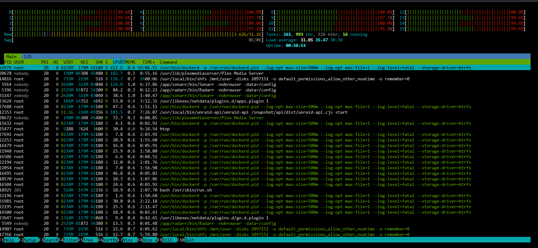

High CPU Usage from /user/bin/dockerd
This started happening a couple days ago. I can no longer run Docker without it maxing out my CPU. Not sure what's going on.
As soon as I reboot or start/restart Docker in Unraid, my CPU usage goes from <10% to 100%. Looking at htop it seems to be:
/user/bin/dockred -p /vasr/run/dockerd.pid --log-opt max-size=500m max-file=1 --log-level=fatal --storage-driver=btrfs
I have tired turning 1 docker on at a time, with mixed results. Sometimes it will be fine, then hours later decide to kick off. Other times, every docker startup will cause this. I have also tried restarting docker in settings and increasing the image disk size limit to 200GB.

I'm experiencing this as well. Did you figure something out? Stopping every single docker container does not help at all.
Edit: Seems like my docker image got corrupted? I createad a new one and I'm resintalling everything and seems to be okay.
Edit2: Now that I've reinstalled everything, seems to be back to the same thing, not as bad but 80% CPU usage now.

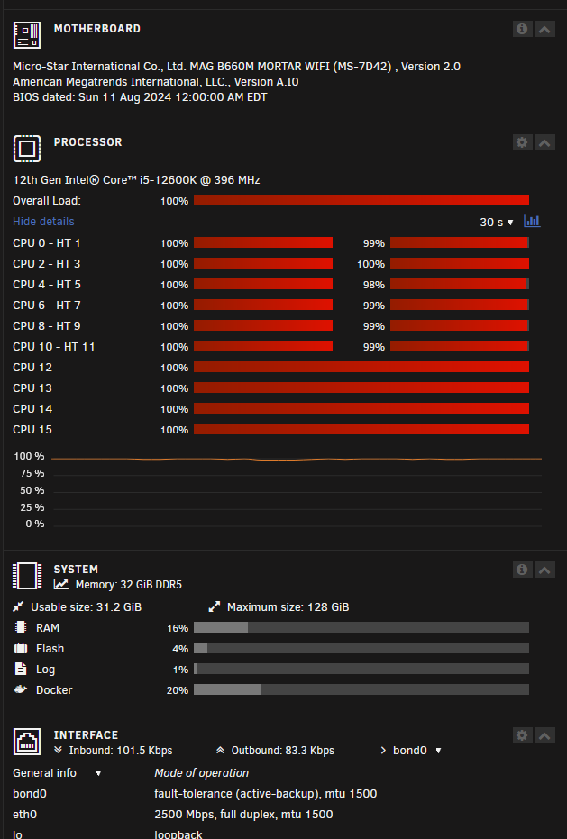

I can report that I experience this as well. For me, this seems to be somewhat related to running TubeArchivist container - but it is definitely not the only culprit.
This might be a coincidence, but what CPU is everyone running here? I am also on the 12600K like @Boy Kai - but on a different MB brand. I am on 7.0.0 but I experienced the same issue with 6.12.x
Your logs are also probably filled with
