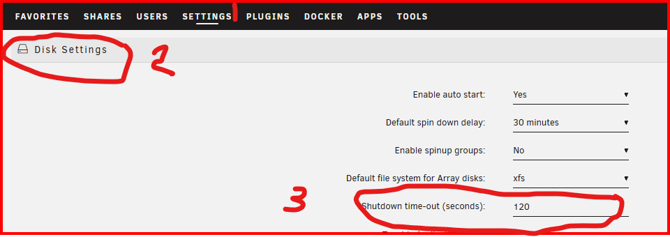

That is true. The quick power button push starts the normal Unraid shutdown script. This script will wait a predetermined time (determined by the setting below) before it forces a shutdown.
If you are having problems with unclean shutdowns, manually stop the array and measure the time required. Then change the setting appropriately. If the time is exceeded, a force shutdown will proceed at that point. (This was added a number of years ago because there were folks (or a shutdown script-- think UPS) who would start a shutdown and it would never finish because the array would not stop!)
