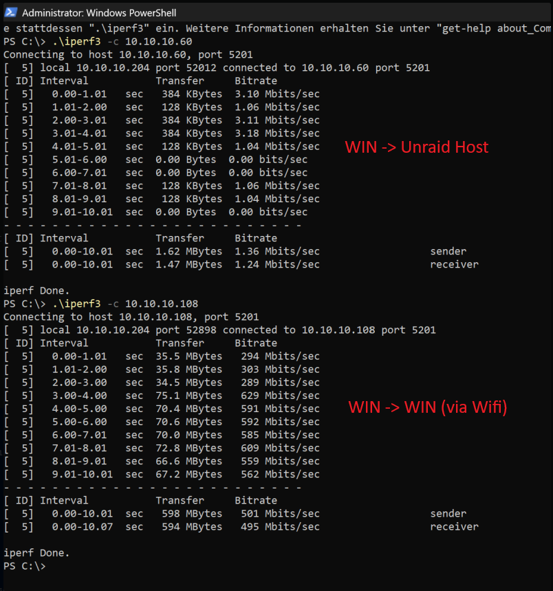

I'm facing a significant issue when copying data to an Unraid host, and I’m struggling to pinpoint the cause. Here’s the breakdown of the situation:
Copying from Unraid to a Windows client: Performance is perfect.
Copying from a Windows client to the Unraid host: Extremely slow (barely a few KB/s).
Copying from the Windows client to a second Unraid host: Also very slow.

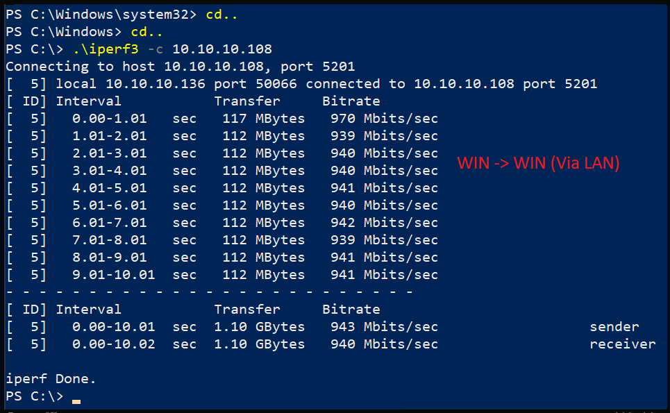

Copying from one Windows host to another Windows host: No issues at all.

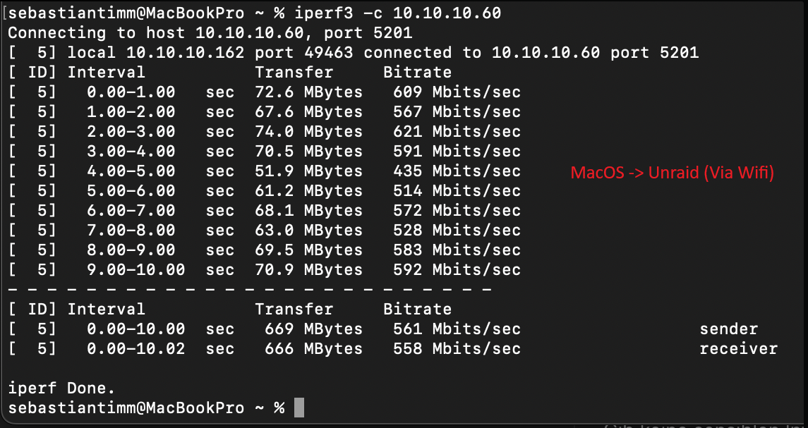

Copying from a macOS client to the Unraid host: No issues.
Copying from a Windows client to a Debian host (Samba share): Works flawlessly.
Copying backups to a Proxmox Backup Server (hosted as a Docker container on Unraid): No issues.
It seems like the problem is related to the Samba service on the Unraid host, but only when writing data from Windows clients. Reading data from the Unraid host works fine across all client operating systems.
Additional details:
The issue occurs on multiple Windows versions (10 and 11).
It persists regardless of the type of connection used (LAN or WLAN).
I tested both with and without using a cache drive, and there is no difference in performance.
iPerf tests reflect the same behavior, showing significant issues during write operations from Windows to Unraid.
Has anyone encountered a similar problem or knows how to resolve this? I’m not sure where to start troubleshooting.
