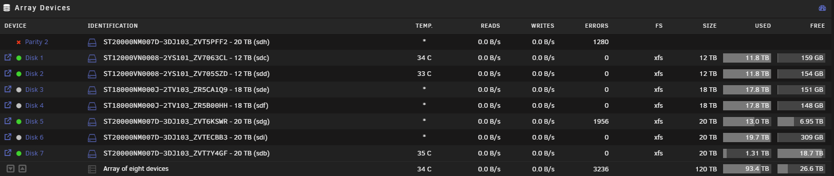

ok I just noticed that my disk 5 also has errors.  weird  it has a green dot next to it, and says "normal operation", but if i try to go to the drive, it says "invalid path"
does that mean i've lost two drives?  I haven't shut down or done anything to the array yet.
image.thumb.png.d8217f5d7c045830f8e7bbc7e4948aa9.pngimage.png.849298ea3f1eba68ad366a192f40a2c4.png

Parity2 and disk5 dropped at the same time, do they share a power splitter or similar?
Also reboot and post new diags after array start.

Thats really weird...  The files that went missing from plex aren't even on disk 5...  thats scary..    New Diag.  I'll own you a couple coffees  thanks JorgeB for helping me.
After the reboot the other files seemed to come back into plex....
They share an HBA card. an evidently low quality one that i will replace as soon as the new one arrives. On the same power supply but not on the same line

Everything looks normal so far, try resync parity, f you have a different PSU it may be worth using it.
