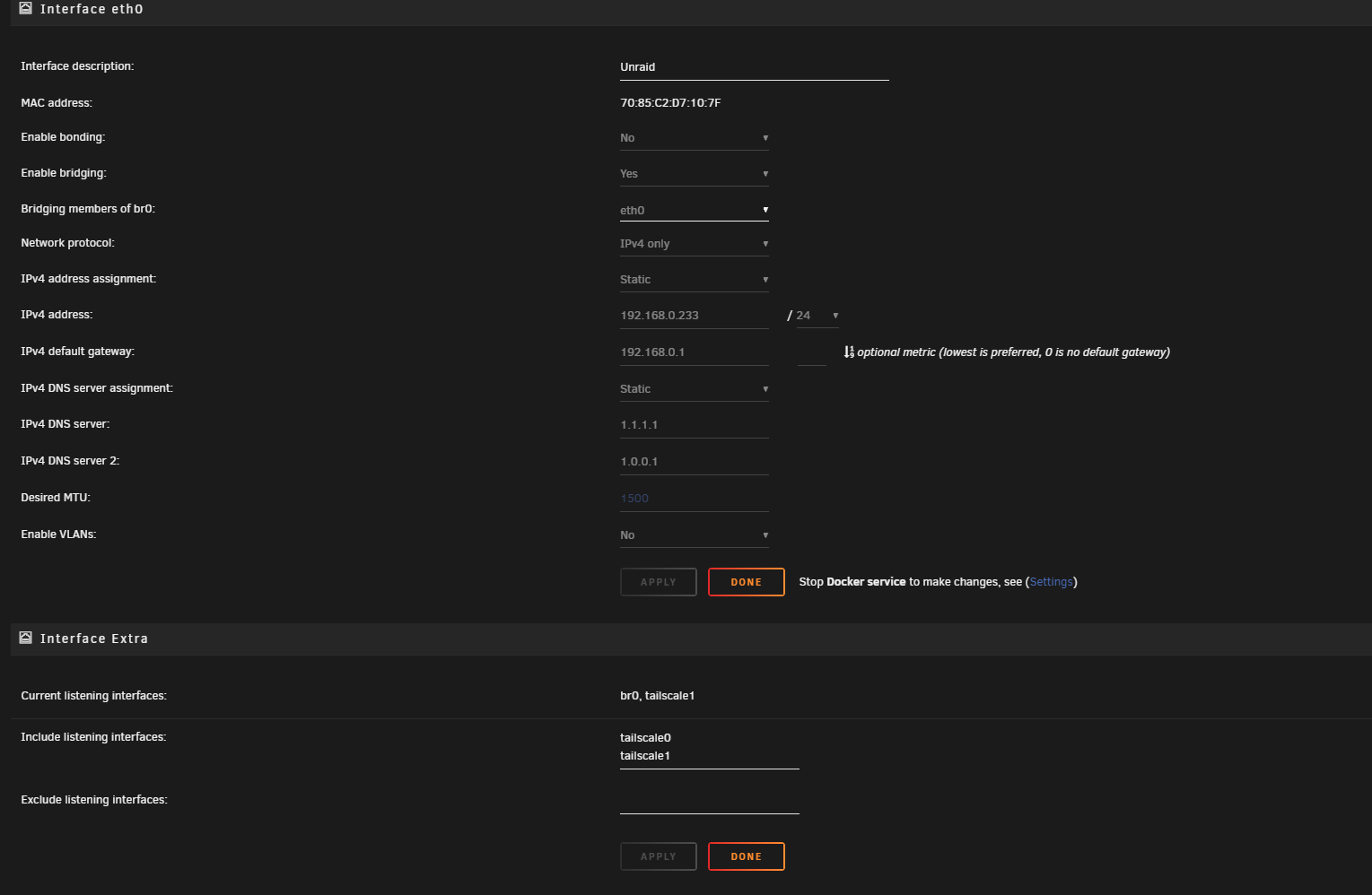

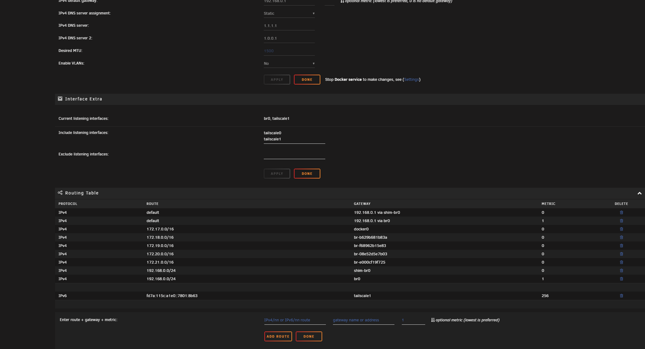

I´m trying to fix my nginx proxy manager. it used to work, but not anymore?? I believe that it´s because of my network setup.. I keep getting dns errors, and i dont know why.. So i was wondering if it´s possible to reset all network settings??

I´m having a lot of problems with adguard and nginx proxy manager.. Could it be because of the ports from http: 1880 and https 18443?? i only want to use in house on lan, so i have not portforwarded.. ??
I have unraid on 192.168.1.200
and adguard on unraid på 192.168.1.300?? I have tried this adguard.home.local 192.168.1.233 in dns rewrites
ports : nginx uses 7818, for dashboard..  Http port: 1880 og https: 18443..
Could some of that be the problem??
Thank you..

I have installed nginx proxy manager, and installed all my hosts, the problem is now that no matter what host i use i´ll be send to unraids login screen..
Anyone who know how to fix this??

what ? is that a tpyo ?
192.168.1.300
the max it could ever be is .255
even then for a standard class c /24 255.255.255.0 subnet the last ip useable is .254 in standard ip networking
you can use .2 - .254
so your adguard ip needs set to 192.168.1.30 ?
your dockers need there own ip address
under docker setting set:
then each docker / service you are runnign has a guranteed ip address and are at that ip:port
