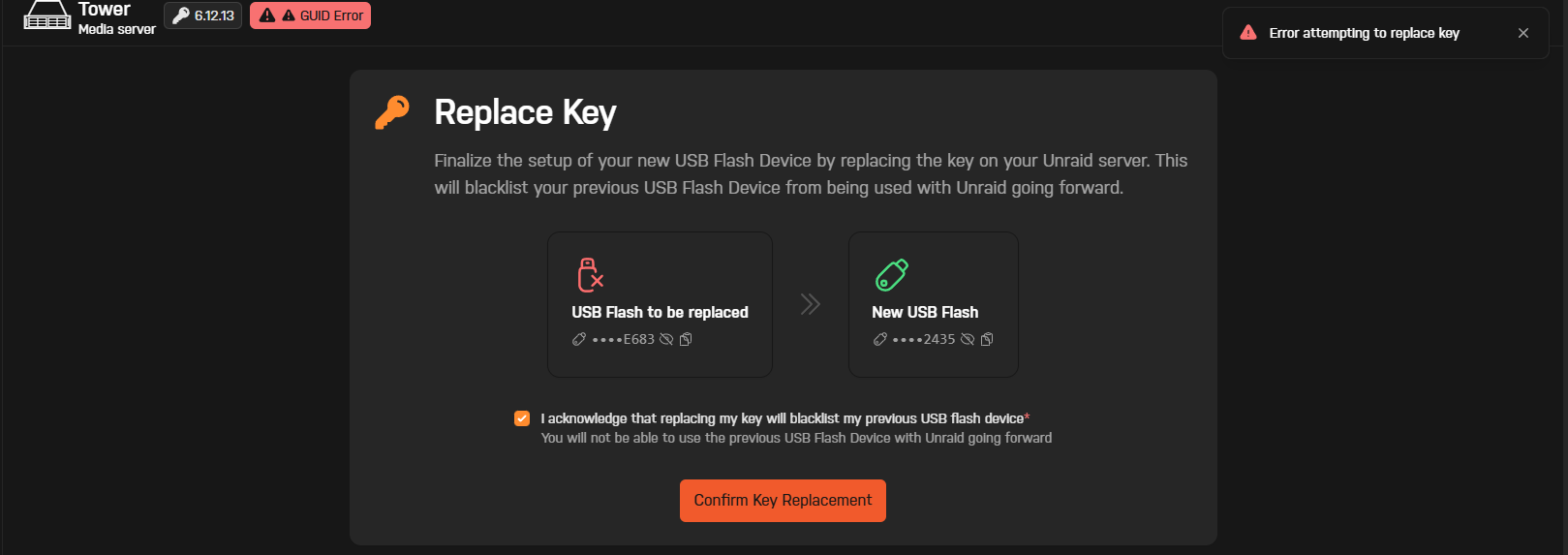

I had my USB drive die (I hope and pray that that is the problem) and flashed a backup onto a new one...went in to swap the license over and I'm getting this non-descript error...
...I clicked the check box, clicked the button and the error in the top right pops up.  Is this a new thing?  Anyone else had to deal with this?  Reeeeeeeeeeeeeeeeeeeeally don't want my server to be down for an extended period of time...I hope it's something simple...fingers crossed...

It appears that your flash dirive no longer has a guid for unriad licensing.
Edited by bmartino1
Most common for this error is using an already blacklisted key as the source, instead of the last valid key, but could also be account or limit related.
The usb is brand new. Limit?...of USBs that can die? I don't understand.
Limit on automatic user transfers, if that is the issue, you need to contact support
Still don't really get it, but I already contacted them, so hope they reply soon.
Thanks.
Once per year.
1 minute ago, trurl said:
Once per year.
Once per year per...login?  Like, my experimenting with v7 6 months ago on a totally different machine is why my security cameras, home assistant and TVs haven't worked in ~12 hours now?...
Once per year per license.
Once per year for any given licence.    If you need to do it sooner for any reason then you have to contact support,   They normally give a reasonably fast turnaround.
That doesn't make sense then...I bought another license for all my v7 adventures...
You can get a transfer failing if the flash drive you are now trying to use does not have a unique GUID and has not previously been used for Unraid.  You need to contact support to proceed if the automated transfer is not working (whatever the reason).
