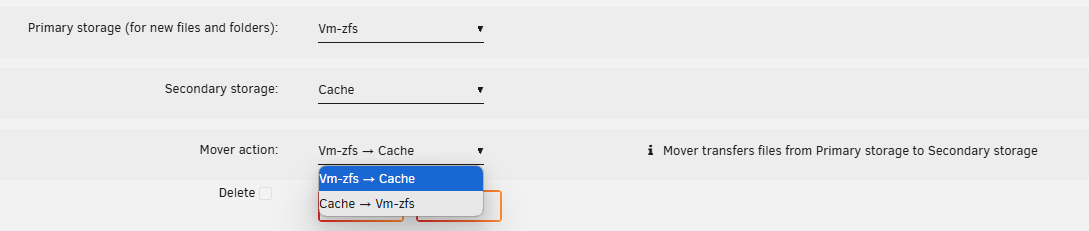

fix your share settings your telling the vdisk to live on a share that is also moving the file to another disk...
the share shouldn't have a second disk set:

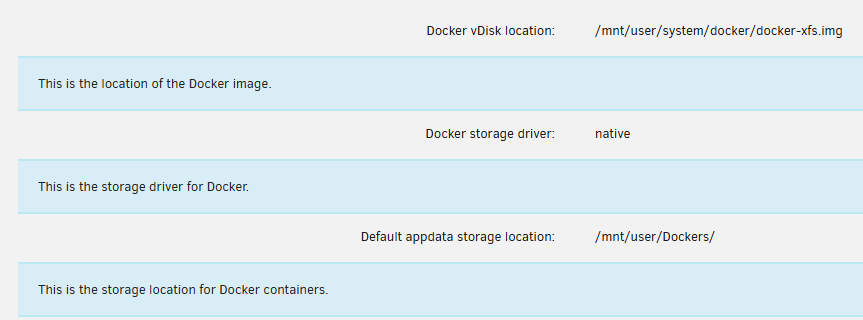

You may need to stop all dockers. push mover to manual push the file and edit docker seting to put the vdisk1.imd on 1 disk at one location.
WebUI > Main > Move
Settings> Dockers:

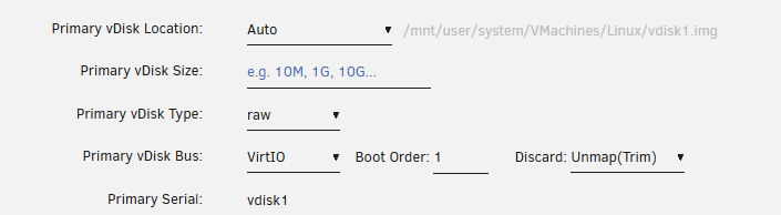

click the picture of the VM go to edit
at the top right click the toggle to show the xml
your looking for the tag disk and need to fix the path to the vdis1.img
general edit will go to form view:
IN this case as example my path is system vmachines the name of the vm the vdisk.img
as mover moved the file and its not at that location, you need to explicit have mover set up as 1 vdisk.img
remove the share setting to that vm path so the vdisk exsit and runs form 1 disk
and edit/fix the vm xml to point to the correct vdisk.img as a direct path.
you need to edit your domain share and eithe have the data set to cache or disk1 per your setup.
^as you have this under domains configured... as i'm not sure which way you pointed it... but mover will move the file from 1 location to the next.
you need the vm off and have mover run to move the data per its current configuration.
(this is to rescue the VM vdisk image as it currently split in 2 disk locations...) otherwise that VM is now dead ...
as atm this should only exist either on disk 1 or cahce per your previous picture data...
To fix so this doesn't happen again...
Then edit the domain share and ONLY HAVE Primary storage set.

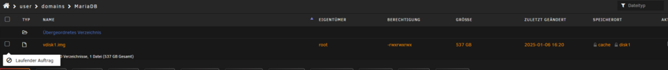

I need a picture of your file manager of /mnt/user/domains/Maradb as in first picture to confirm file location

Correct now that file manager shows the vidsk in 1 location and the vm xml is pointed to that vdisk1 image file. if the VM done't boot the vdisk image is corupted and will not funtion.
editing the xml location to point directly to the VMS vdisk at this stage should work. the direct path should be /mnt/disk1/domains/maradb/vdksik.img <corect any spelling and actual path as it is case sensitve..)
as teh vdisk was broken into 2 seperat parts beforem coming one again new data old data to the vidsk.img is most likly coreupted for tryign to move or hold /replace data that is not seen at the host level and in the virtual level inteh Hard disk the mover replacing the file overwrote large section of the virtual disk...

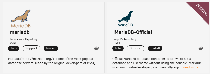

outside of snapshots/vm plugin. why a vm of this when a docker would runn faster and smother.?
I would direct you to use Mariadb docker:
and set a path for the physical mariadb data on unraid...
i had a VM becaus the Docker had some errors i cant explain and just wont work so i just set up a Linux VM and installed MariaDB ther and it worked flawles at second 1.
