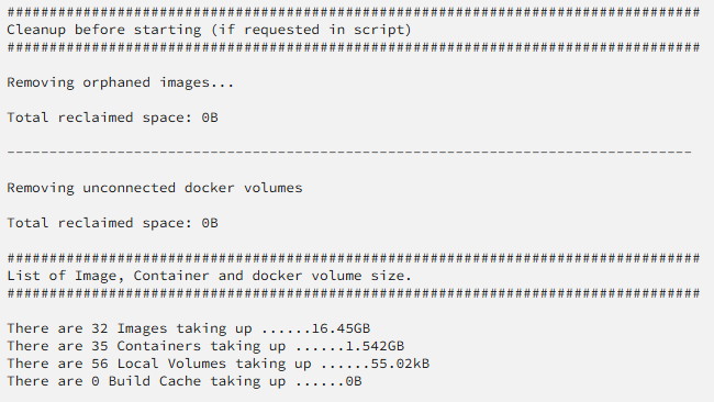

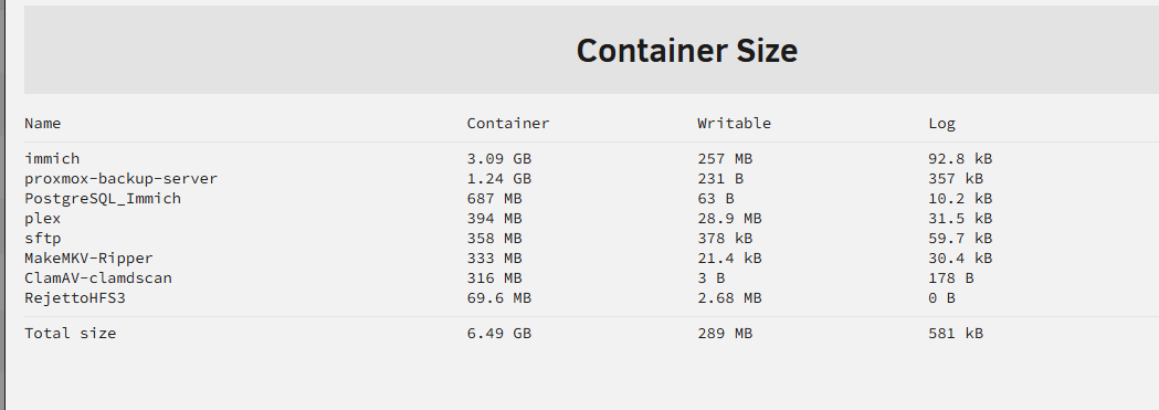

My docker Image is 80GB in size and 55GB are in use.
When I do a docker container size calculation, it shows a total size of 21GB.
When I run Spaceinvader One script it matches with the docker calculation above.
So my question is, what is using 30GB of additional space when everything else suggests there should be 21GB in total?!

in unraid webUI > Docker Tab click container size:
example:
if you don't see it here. you may have old docker build cache. this can be hard to remove soemtimes.
I have a script that i run to assist this but this will remove any and all non runing docker services...
Edited by bmartino1
Thank you, I have also tried that, still the same...
