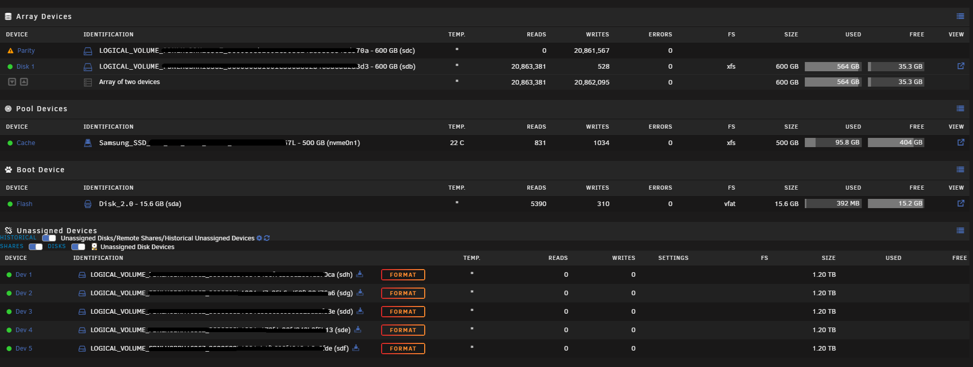

I'd appreciate if someone could assist me with the parity swap procedure since I can't make it work for the last 2 days. I'm trying to follow the guide that is shared by unraid but somehow I'm not doing something correctly.
I attached a screenshot where you can see what's up in my system. I have two 600 GB drives added to the Array, and I have five new drives each 1.2 TB. The new drives are added to the server and I pre-cleared them.
I want to add these 5 new ones to the array and I want to still use the 600GB drives also since they're completely fine drives just small :)
I'd be glad if someone would write me a step by step guide on what to do using the last 3 numbers of each drive.
Thank you for the help!🙏
Solved by itimpi
The parity swap procedure is not relevant to your situation as it only applies when you are wanting to replace one of the (typically failed) existing data drives with the old parity drive.
You should simple stop the array; assign whatever parity drives you want; and restart the array to build parity.  When that completes you can follow the standard procedure for adding new data drives to the array.
