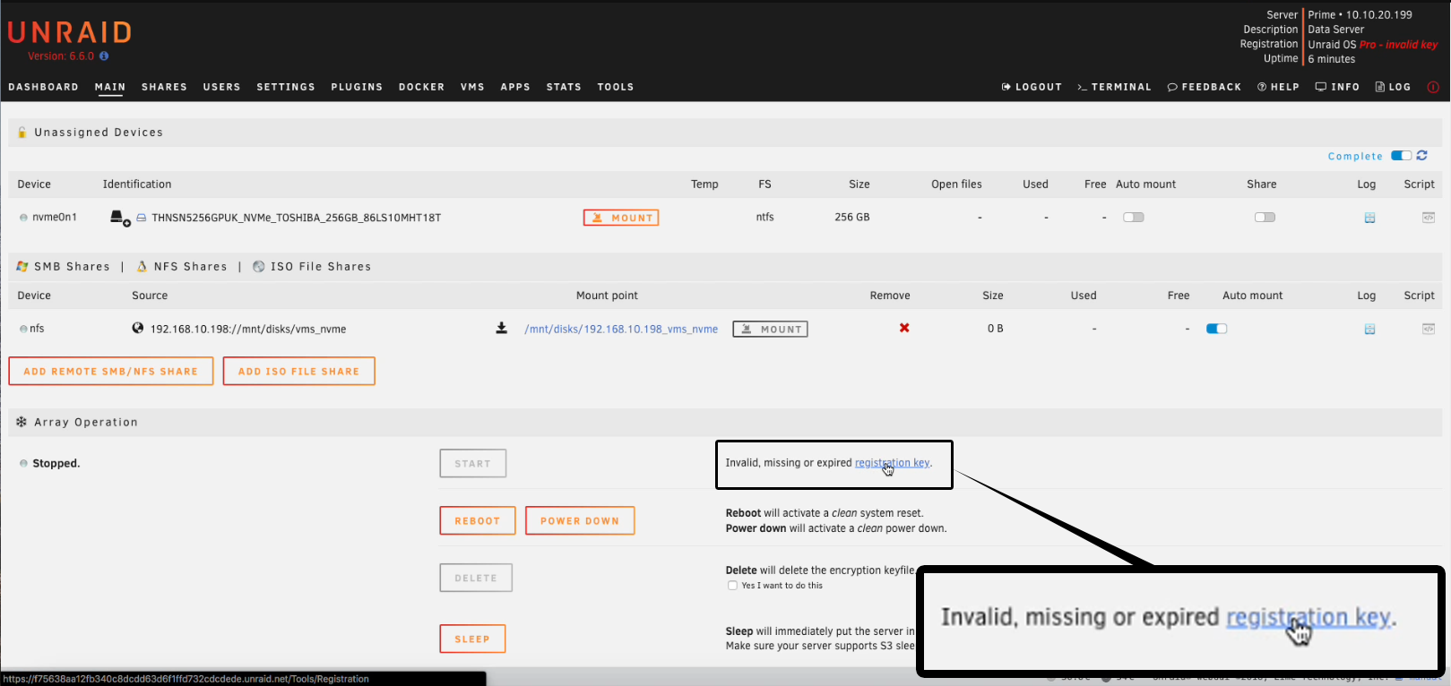

On 1/10/2025 at 2:22 AM, ich777 said:
You should probably upgrade your USB Boot device first. :)
So I got the same error. Had a new 4GB Sandisk Cruzer and used the USB Flash Creator to load my backup on it. No matter what I do, I can't get a WebUI. No easy way to hookup a monitor either. I was expecting that I would get this screen upon boot but nada:
Any thoughts on what it could be? Using my old 2GB flash drive works fine. Worst case, is there still a manual way to upgrade (i.e. I remember back in the day just replacing a couple files to ugprade but that was a while ago!).
The one thing that just came to mind was the network cfg settings in the USB Flash creator. 2 options: DHCP and static. I have my router configured to assign the IP address of my server based on the Mac ID address. In any case, I used the manual method and put in my IP, gateway and (primary) DNS server info. Should I retry with DHCP?
Difficult to say without seeing if it's even booting correctly.
Is there still a manual way to upgrade from 6.12.14? What files do I replace on my current 2GB Flash drive to upgrade manually?
You can grab the update here. Unpack the zip file and replace the bz files on the root of your flash. BE SURE TO GRAB A BACKUP FIRST THOUGH.
Ok, so just the bz files need updated? I wasn’t sure if anything had changed from the days of OS 4 and 5! Thanks
