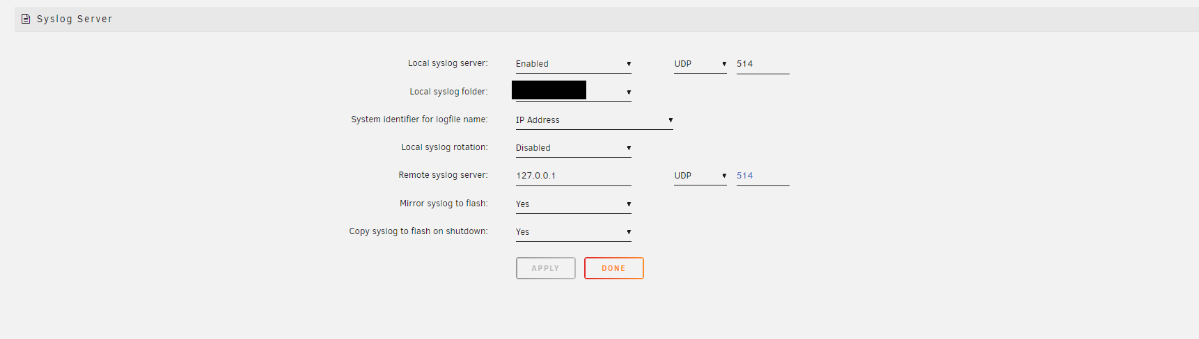

I had the syslog server enabled, but as of right now the latest syslog previous was a clean reboot after installing unraid 7. I did not realize that the syslogs containing my crashes would not persist. Is there a way to avoid removing old syslogs from my flash?
If saved to the flash drive, only the previous log will be kept, but if you save to a share, it will keep a continuous one.
Thank you for the help, I have that enabled now. I have not had a crash since updating to Unraid 7. Hopefully the newer kernel fix my issue. If I have another crash now I'll post the syslog.
