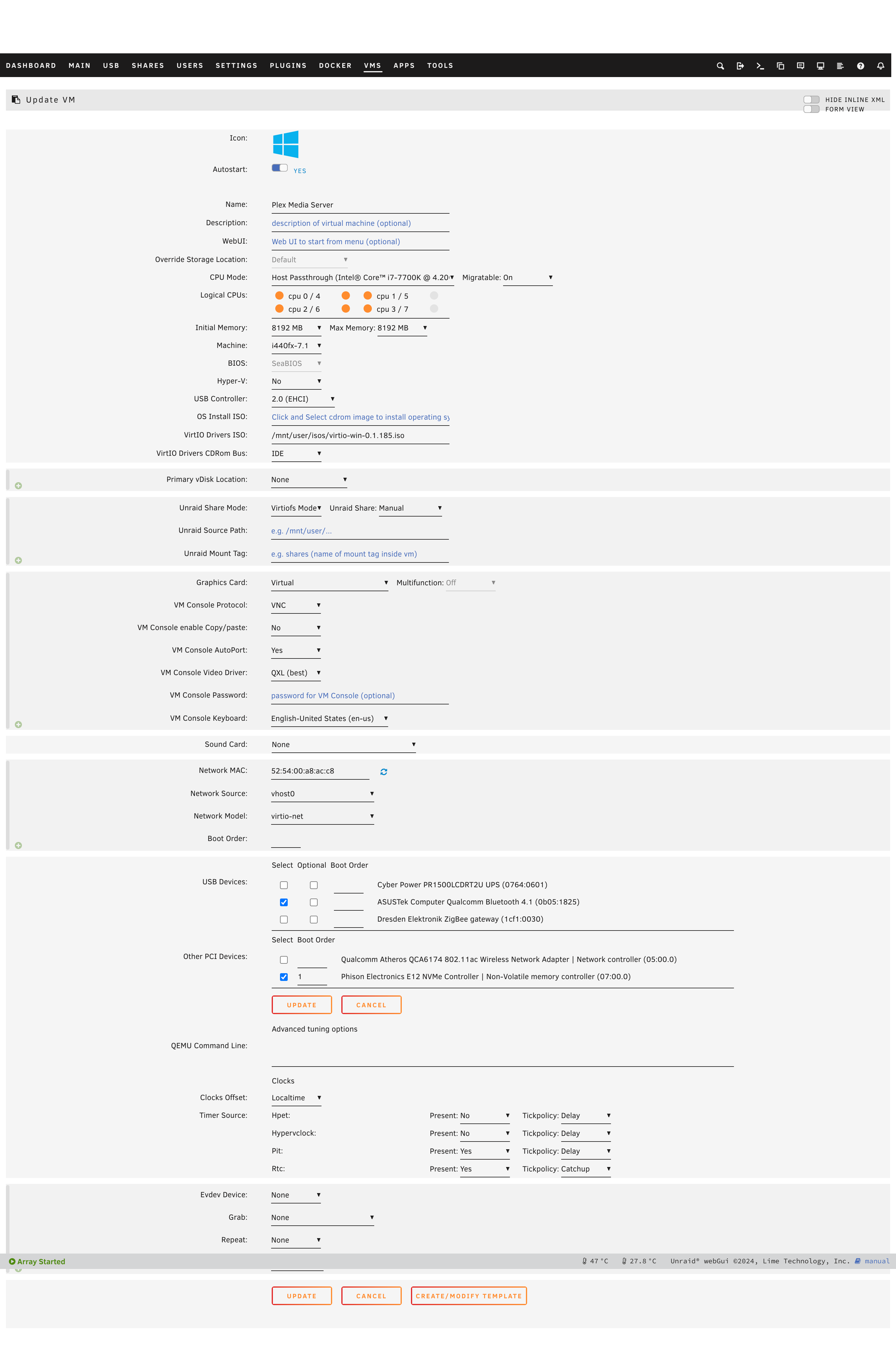

Post a screenshot showing the form view, in case it helps.

Looks lspci and gui looks ok. Do you get the  ovmf boot screen if you start?

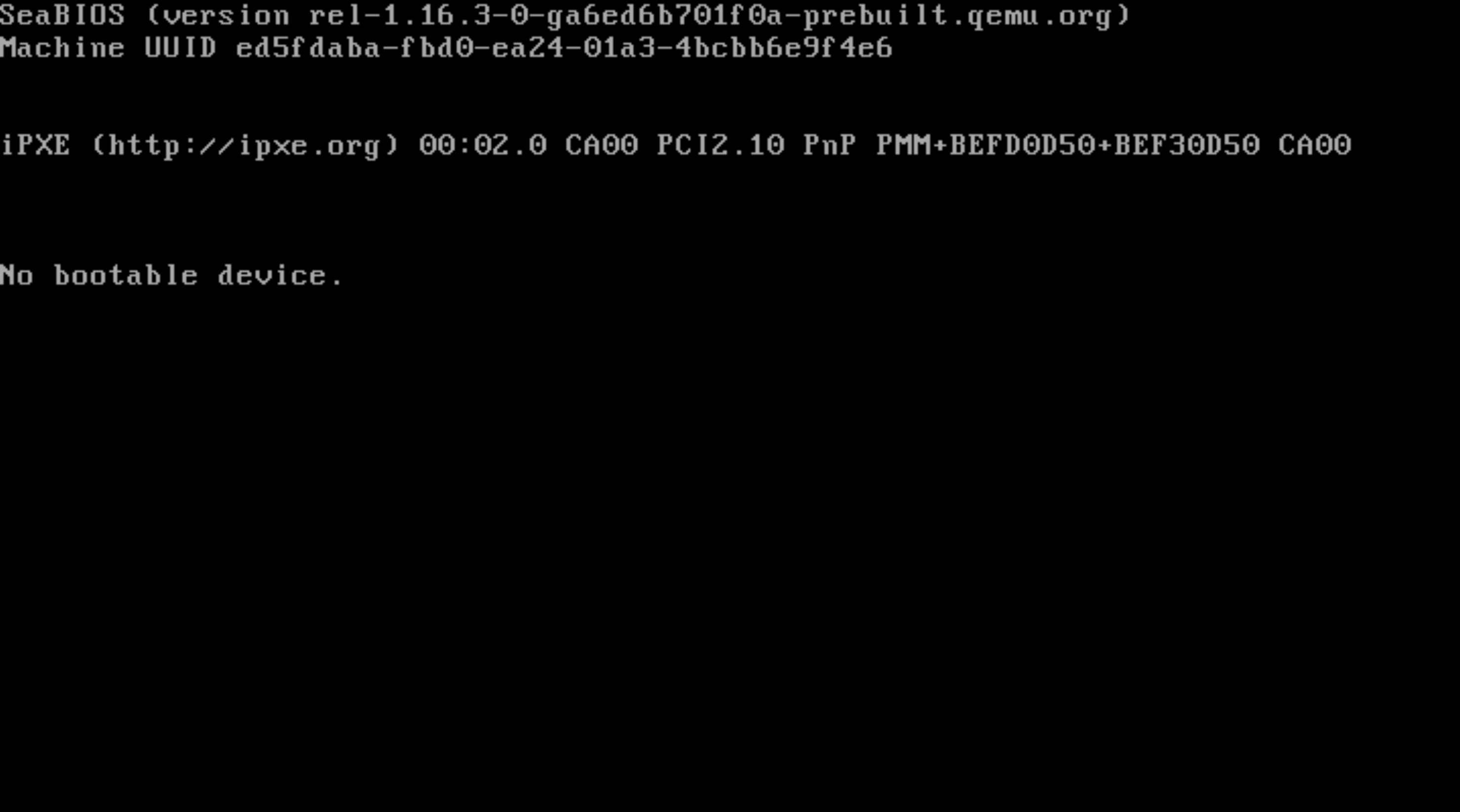

I immediately hit this screen upon boot.
Try removing the boot order on the PCI device, other thing to try is pressing F1/DEL to see if you can get into the bios when you start and see if you can select from the boot menu
