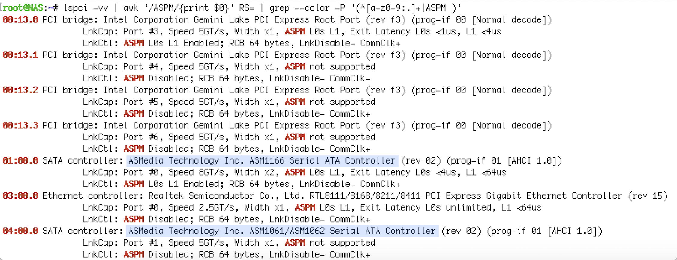

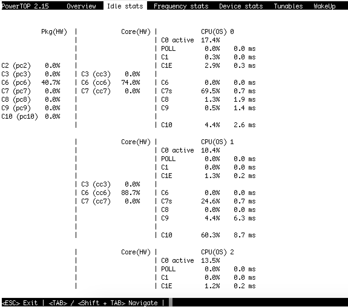

Since swapping my HBA for an ASM1166 card I can reach C6 but no lower:
The relevant bios settings are C1/C6, C1E, and L0sL1, all of which I've enabled.
Curiously while the ASM1166 PCI card shows ASPM Enabled,
the onboard ASM1061/ASM1062 shows ASPM Disabled.
I'm wondering if it's worth it to probe further.
Im pretty sure the AsRock Boards are all capped at C6
Given that you mention C6 specifically there, i bet the bios/uefi are identical between the j4125 ive and yours. So yeah, they put a cap on that. Not worth it either, cause they draw so little power anyway.
